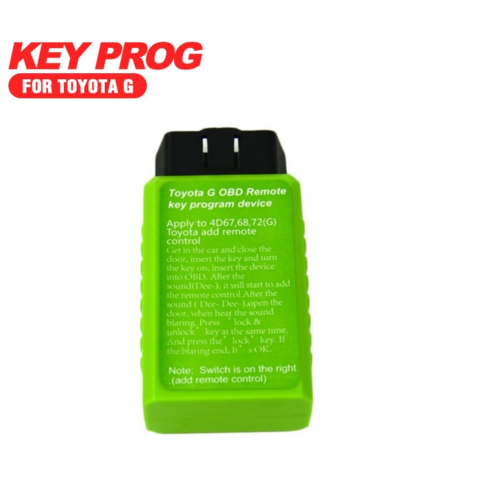

Has anyone used one of these devices? It says it can program remotes and transmitters for H and G keys:
https://www.amazon.com/ICARSCAN-Pro...coding=UTF8&psc=1&refRID=SPCT17N78MTGWHZG7BCP
