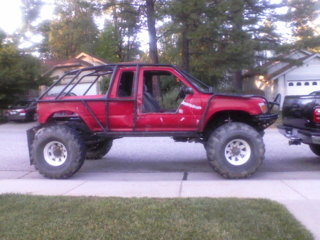

Now we are here.
DSC032731-1.jpg~original
DSC032742.jpg~original
From this
DSC03082.jpg~original
To this
DSC032764-1.jpg~original
Next up Fuel, Exhaust, Shocks.
