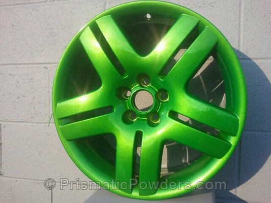

-1 set of 17" 2004 4runner rims with 32" wranglers on them powder coated metallic green.

Pumped to see this build! pics look killer! :frog: Are the rims on your current runner the 04 4runner rims? Going to be green like the engine? (which also looks sick, great attention to detail!)
I head you on the shop being far away.. Just have to make your shop time count!
here is the green paint for the rim
