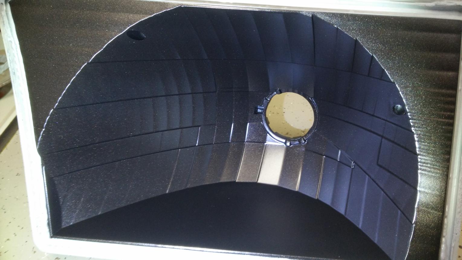

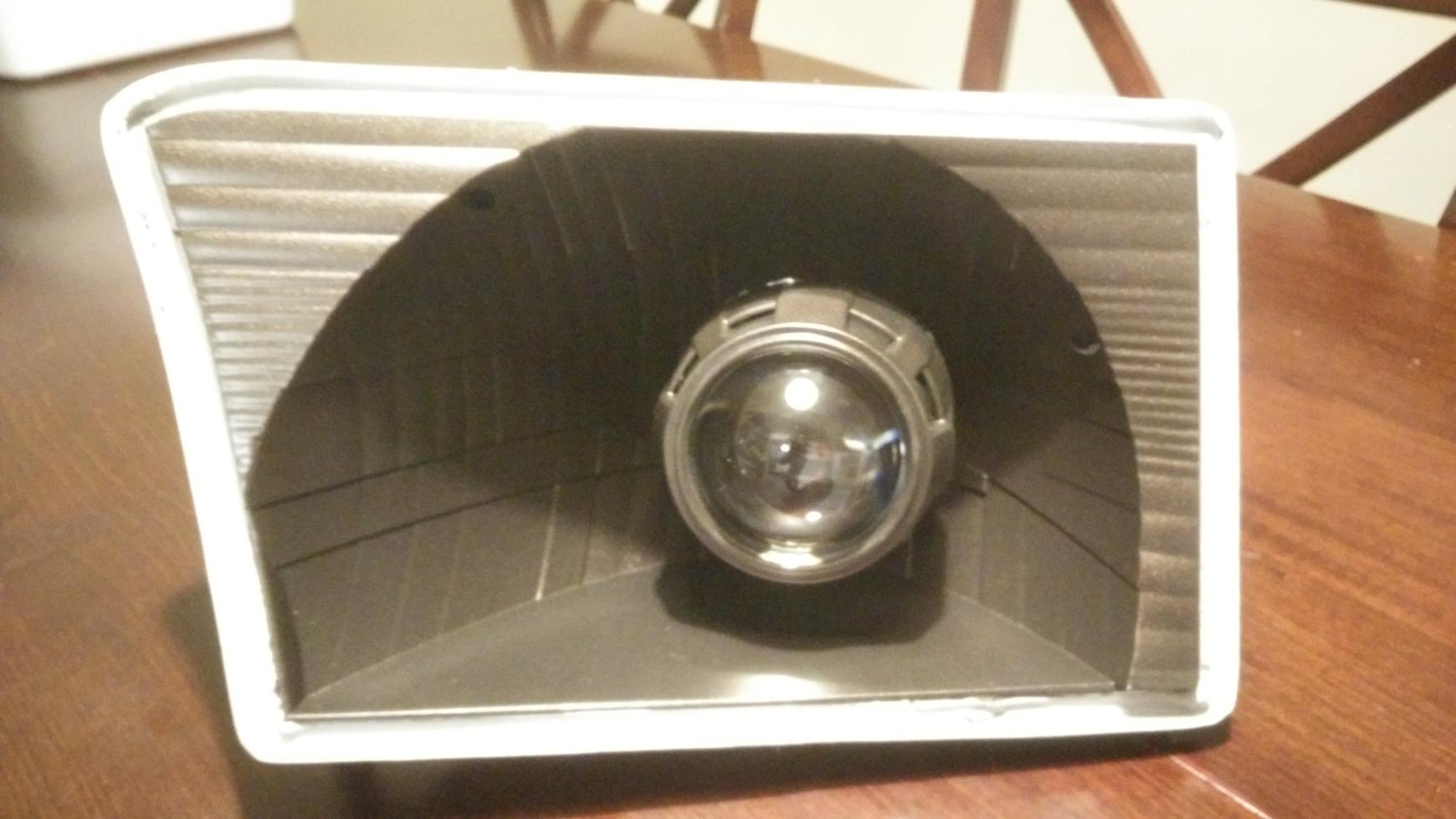

Hey Everyone,
I installed the amazon projector's off Amazon found here:
https://www.amazon.com/Nilight-Mini-Bixenon-Projector-Lens/dp/B00B21R0TA/ref=sr_1_3?ie=UTF8&qid=1540932773&sr=8-3&keywords=headlight+projector
I realize these are cheap and not Morimotos' but they fit the budget at the time.
I have these installed, they look great but they are nearly useless to me as they point too far down and not allowing me to get enough light in the distance. When I am driving, I can see about 10 feet in front of me. I have tried reinstalling these twice (re-baking the lens and everything) and still have not been able to get these to aim higher. I realize that there is an adjustment for the horizontal and vertical adjustment, but they honestly don't provide enough height even when maxed out vertically ( which makes the bottom of the headlight stick out and look terrible)
I believe it must be due to the "conversion" h4 adapter plate and silicone ring. Between the projector, and the actual housing I used the silicone ring as the barrier to keep out moisture ( I believe that is how it is supposed to go ) with the adapter plate and nut on the outside of the housing. I then put the hid bulb in between the adapter plate and clip the spring down. It is as if I need a shim to help angle the projector light up vertically so that I can get further project the light. It doesn't seem like others have had this issue so it may be user error as I am not a professional.
Has anyone else had these issues?
Try not to flame me too bad :behindsofa:
Thanks for everyone's help!

When I did mine they were aimed down a bit further than I liked. I cut a piece of foam and wedged it under the shroud to prop them up a bit. My shrouds are bigger than yours and you would never notice it unless I pointed it out and you really looked for it.
You can aim the entire headlight assembly as well so you can tilt the top back and push the bottom out. I tried this initially and wasn't happy with the alignment of the headlight bucket relative to the grill etc. hence the foam.
Check that your threaded projector shafts are 100% perpendicular with the clamping surface on the back of the factory headlight reflector bowl. If the threaded shaft is smaller than the opening in the reflector housing it can go in crooked and you will fight the silicone ring to correct it. I did a trial install without the silicone ring to get mine aligned right.
FWIW I purchased and returned that kit from Amazon and opted to go with a pair of 3" D2S projectors and Panamera shrouds from DDM. My install post is here
I had to trim the shrouds at the bottom, too large for the housing, but the projectors went in straight with the silicone ring in the same position as you installed yours but I did have to test fit it like said above. With the projectors properly aligned in the housing you should have no issue with alignment or aiming with the factory adjusters unless there is something amiss with the p[projectors themselves.
i purchased those same projectors. i got them as a place holder as a sort of proof of concept and I had intended to upgrade if I liked how things came together and wired up. Turns out, I think the projectors and lights work great, I'm going to stick with them. I'm not sure why the expensive projectors would be better for me, unless the solenoid broke or projector housing, but will see how that goes. Sounds like purists get all excited about a sharp 'cut off line'. Mine seems just fine, and I don't know why that's important. I'm not entering any lighting contests.
When I assembled, I made sure that the projector threads came through perfectly centered in back of housing. I pushed pretty hard on projector to mash the silicone washer while tightening rear nut as much as possible so the projector would not sag. Maybe that's what's happening? I also snaked a ring of butylene around rear of projector along with silicone washer to act as a sort of glue and sealant.
Worked great, only needed a small adjustment. I think your equipment is prob fine, maybe try plenty of pressure on silicone washer when tightening.
I like the paint on your shrouds btw.
Even the TRS drop in projectors are by default "down quite a bit" so without knowing more it would be a bit difficult how yours compare.
you WILL run out of vertical adjustment to correct this. these drop in ones need a support from the underside to hold them in place.
The small rubber ring compresses over time and the unit droops inside the enclosure.

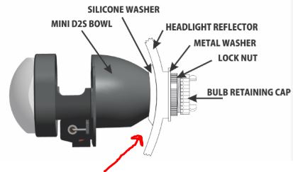

Since things get pretty hot from the HID bulbs, I want to use a material under the projector to "prop up" the projector that won't potentially get too hot and catch fire. I figure foam has the potential to melt, what would be the best material to use between the silicone ring and the projector? Just another piece of silicone?
I realize this is a picture of the d2s projectors, but it at least shows a visual of where we are talking about putting a wedge under the projector.
