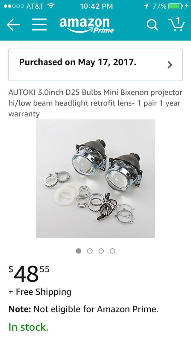

IBallEngineer, as mentioned on the first part of my post I all ready have the Projectors, shrouds and the ballasts (see the below photos attached)I only need the parts listed on the second part of my post but have doubts if these are the correct. Thanks for your response.

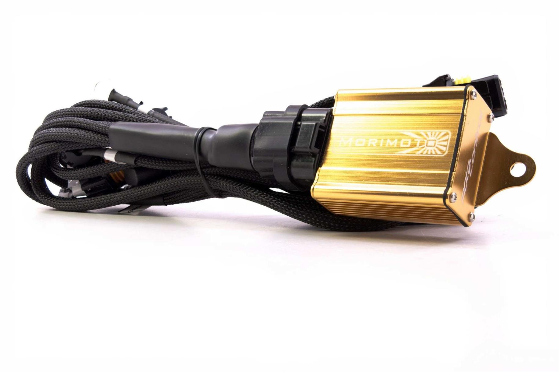

this is the harness you want you will have problems with the other harness
https://www.theretrofitsource.com/wiring/relay-harnesses/motocontrol-bi-xenon-h4-9003.html

Thanks I appreciate your help, but since at the the Retrofitsource.com the cost including the shipping to my country are near the $400.00 and I already have the parts showed on the above pictures, I prefer to buy the rest of the parts to complete the project but my doubts are if the three parts mentioned on the second part of my fist post are the necessary. Thanks again for your response.

monkracing29, I only need one Motocrontrol Bi-Xenon H4/9003 for the project or need two? As per the product PDF Diagram on the theretrofitsource.com, with one Motocontrol I can install both projectors but I have doubts. Could you let me know? Thanks, again.
You only need one motocontrol harness. I strongly encourage you to rethink the cheap amazon ballasts. Your going to be pumping juice straight off the battery to the 55 watt ballasts. If those have a melt down, which lets be honest, Chinese mass production quality, it's more likely to happen than I would want to chance.
You don't need the weird pair of plug adapters if you're going to use the motocontrol harness. If you want inexpensive quality ballasts I can help you track some stuff down.

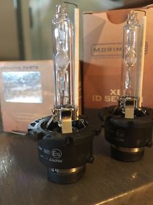

Ok, I finally purchased the following parts to complete my project, I hope all the parts be perfectly fitted without any problem. As soon as the project will finished I will to post some pictures. Thanks to everyone.
1) 2 Morimoto XB35 D series D2S 5500k bulbs
2) 2 Morimoto Amp to D2S ballast adapters connect to any HID Ballast
3) 1 Morimoto MotoControl BiXenon H4/9003

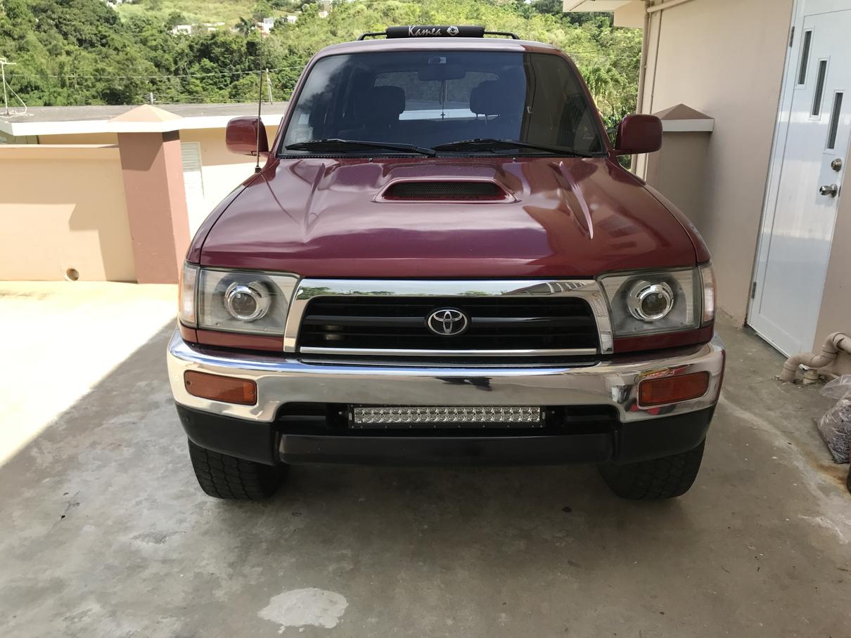

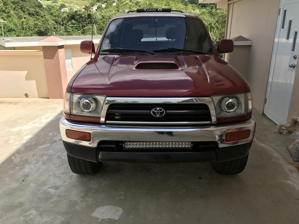

Finally my Retrofit Project finished.

Good job!
I installed rubber O-rings between the DS2 connectors and the bulbs to help keep moisture out. Pick up a 10-pack at OSH in the plumbing department for $3, IIRC they were about 5/8 dia and fit snugly, requiring a bit of force to get the connector on the bulb. A bit of dielectric grease on the o-ring and around the connection goes a long way too.
