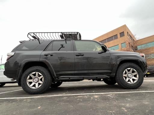

No mods beyond fender liner and maybe mud flaps necessary. I currently run 34" tires (285/75/17) on stock trail wheels. I have all my OEM suspension installed right now - both front and rear fox suspension I have is out for rebuild/replacement so I tossed the OEM stuff back in. They still clear without any problems, although I do have a BMC done and it is needed for 34" tires.
But - the main point is that I don't have any rub on the top of the fender areas even at full compression. If your tires clear the mud flaps and front bumper/fender liner, you should be good to go on the trails too. You might flex the rubber bushings enough to get a very light rubbing, but it shouldn't be much. The only times I ever get any rub on mine is in reverse pulling out of the driveway when it rubs slightly on the front bumper/fender liner.

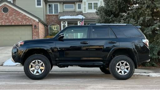

Thanks for the earlier comments. I’m now lifted with 3” OME lift with OME UCAs, which helped with caster. I did move front fender liners forward and trimmed inside of bumper to match (looks like it came that way from factory). The alignment specs are good, and I think the 255/80 17 Wildpeaks ride well at 40 psi for an E load. The steering wheel wobble is also gone. All in all, love the setup.
I like that stance. Looks sharp. How is your mileage with this setup versus the factory setup?
