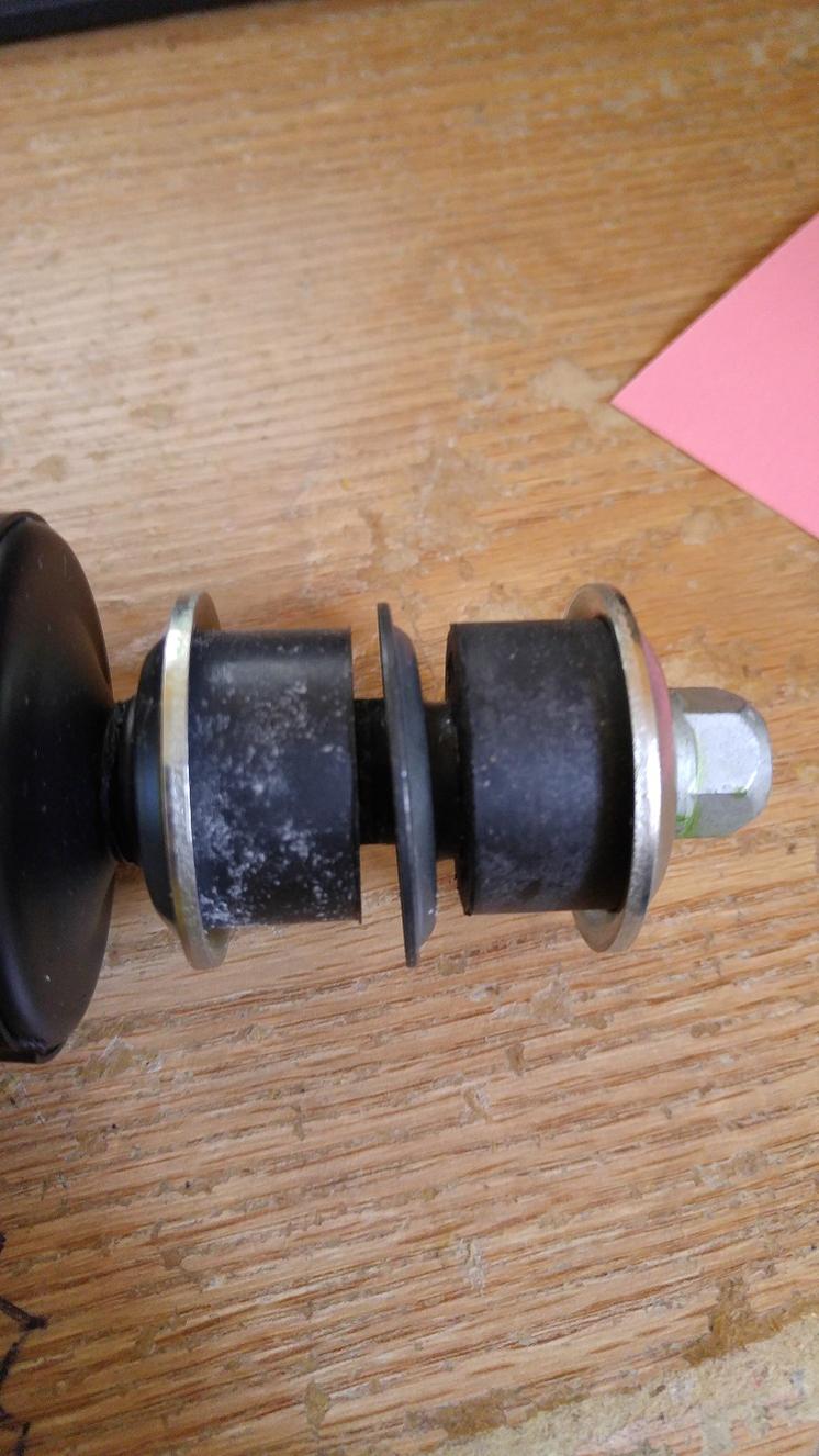

Hi everyone,
I did a few searches and youtube video on proper order of mounting hardware for rear shocks. I feel like this may have been covered a few times, but I dont think I've seen a complete picture with the proper order of bushings for the top nut, and lower mount.
the picture is kind of vague as its not high enough resolution, but based off my search, I think this is the order. Please correct me if I am wrong .
I have a 2002 4runner, these are OEM shocks with new mounting hardware.
Just want to be sure:
See attached picture,
Top:
nut
top retainer 90948-A2004
bushing
BODY(Unsure here, going to compare once i get in there to be sure)
Middle retainer: 90948-02119
bushing with lip:
lower retainer:90948-A2004
Bottom connection:
outwards --> in
Lower shock bolt:91619-G1222
washer lip outwards: 90948-03020
bushing: 90385-19007
bushing:
washer lip facing body: 90948-03011
First time doing shocks, just want to be sure.
Thanks in advance for any help :)

Whats the point of the middle washer on the upper shock bushings? I dont think my bilsteins came with them and I don't remember seeing them on the shocks I removed that looked original.
The top picture is how they came from the factory. The middle retainer (washer as you called it) has (or should have) an upward facing lip which matches the lip on the bottom bushing, and centers the shock stud in the frame mount.
OP, you have the order correct.
yeah few aftermarket setups don't even bother with the middle 'retainer cushion'. I was confused as heck, I thought you don't want metal on metal contact hence the point of the bushings
still not sure why the middle is there, wouldn't the metal on metal make a noise? I guess it doesn't but not sure why lol. Anyway thanks for clearing this up. !
