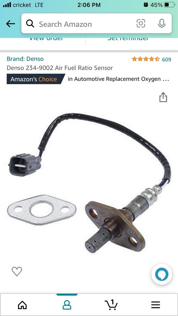

Looking at the NEW Denso I put on, AFAIK, it’s legit Denso, so perhaps it was just a dud?. See pic for the etching…
Welp, I tossed the old air/fuel sensor back on. Truck runs just fine now. WTF.
I haven't ever seen one bad from ledgit sources. They are definitely getting better at making them look ledgit.
How was the price comparable to the oem one? From Rock auto or autoparts stores? If they are not in the ball park of those sources. It's quite possible it's fake. :(

I paid around $140-150 for this, i’d have to check to find a specific number. When searching around for replacements, I definitely did see some were priced out around the 35 to 50 mark, not listed as Denso necessarily, or even Bosch, but I wouldn’t suspect a part that cheap to perform at all, let alone as well as an original piece that cost 45 times as much.
I suppose it’s possible that I bought an expensive knock off, or that I got a dud despite it being legit. Could the fact that it had been sitting on my shelf for a number of months before I actually used it have affected anything, just out of curiosity? I can’t quite wrap my head around any reason why that would make a difference, considering all the where in tear a normal part would get, but you never know.
Sitting on the shelf for a few years shouldn't hurt it any.
That's around what that front one would cost.
I just can't say I ever seen a denso sensor bad from a reputable sources.
I guess it's possible ones bad and it's possible that it's a knock off too.
Regardless, you know what caused the pulsating rpm is from a bad sensor.
I don't know what to say. I think it was a counterfeit sensor but I could be wrong. :)
