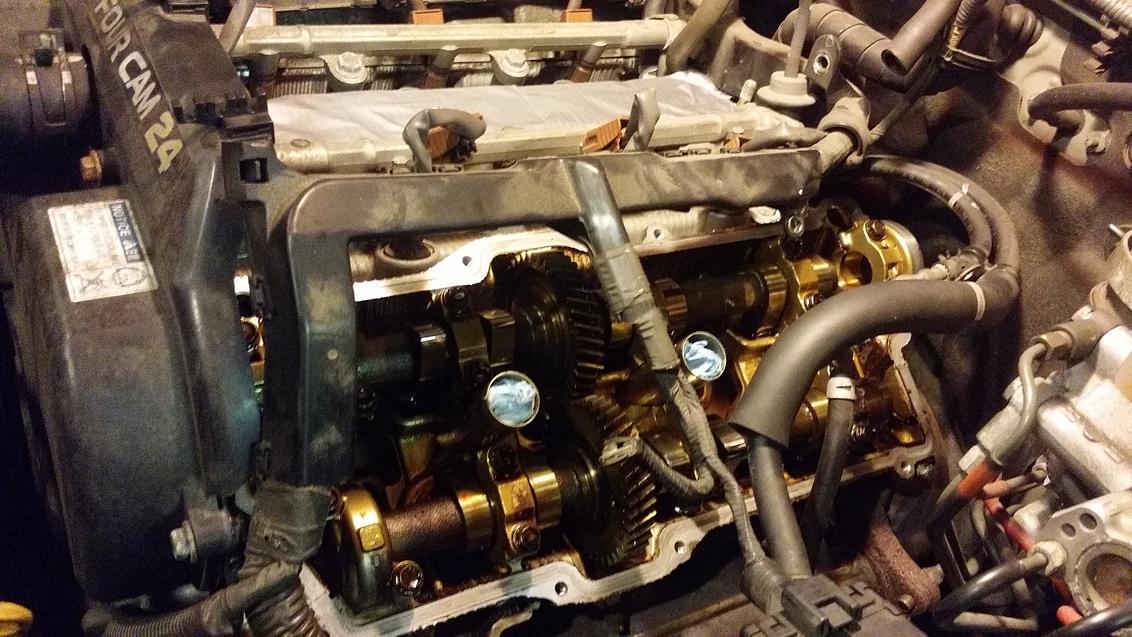

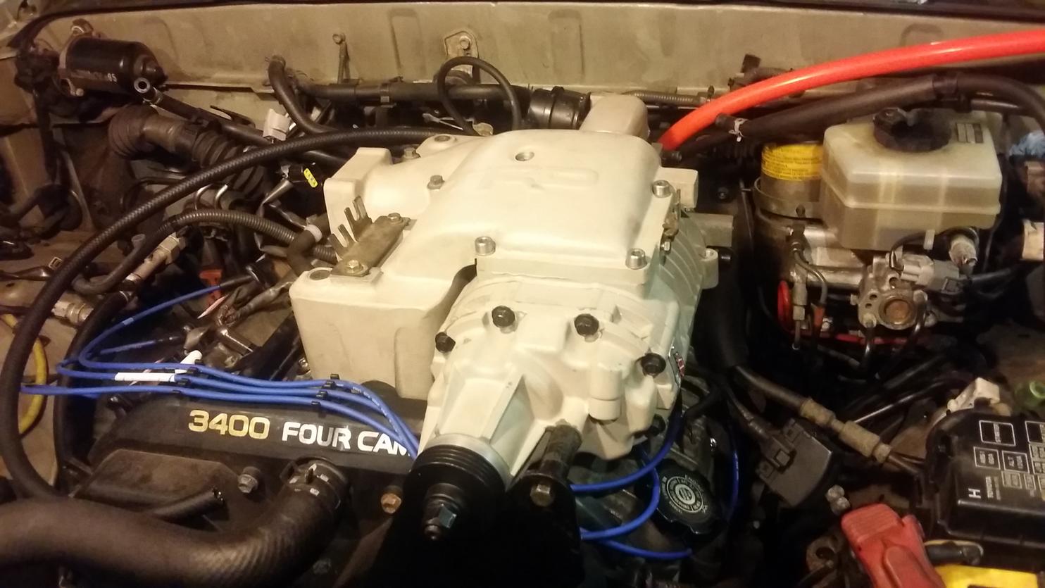

I never updated this thread...I went ahead and just had everything done. Timing belt, water pump, tensioner, hoses, etc.
I just did the valve cover, spark plug grommets, pcv, spark plugs, plug wires and slapped a supercharger on as well.
