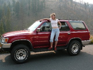

7 months has gone by since I bought the 95 4 Runner. I have put some money and time in this truck...BUT....I do love it and hope it keeps going strong for me. I replaced/had replaced... shocks, tires, 2 siezed castor bolts before it could be aligned( costly and painful), pitman arm, front swaybar end links/bushings, control arm, upper ball joint...this solved the sterring shimmy...there is more. I learned alot and now it is back to the tailgate window failure. All in all...I am glad I bought this 4 Runner. Learned how to display the trouble codes if the check engine light comes on. Found out what the sensor was that was bypassed(egr sensor). Changed all fluids untill clear and flushed the cooling system. Here in Yellowstone it gets down to minus-60* below zero...no brainer. New windshield....I know there is more...oh yea...sagging rear end needs new springs.....and rusted bumper ends and new grill, clips and headlight housings....should be done then....right..
Thanks for the help on everything guys. PS..got the girl cuz of the truck.....

is that icon supposed to represent how you feel about this girl? :D
ICON
No.....That ICON represents me..smashing my own head in for going too fast around earthquake lake last week on snowpacked roads. I had a deer run into the passenger door...it cost me $$$$1400.00 to fix it. :happens: Otherwise....I have this 4Runner almost restored to where I can just drive it.....instead of dumping money into it with a front end loader. Still have the girl......
