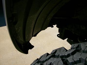

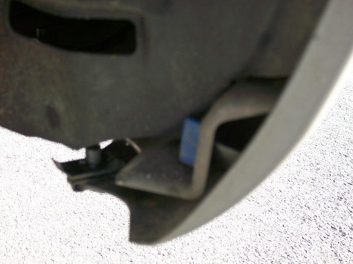

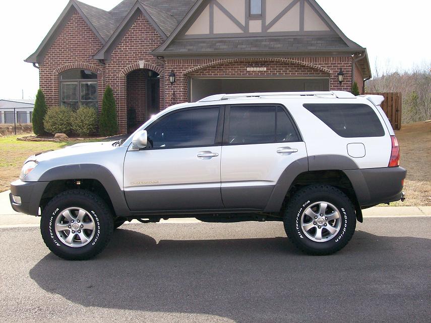

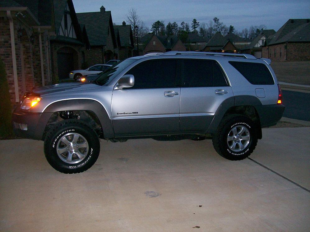

You will need to do alittle trimming, no big deal.
As for wheel spacers, if you have a 17 inch wheel you do
not have to have them to run a 285/70r/17. I have a 3/2
cornfed w/ 285 BFG KO'S. I too was very worried about the rubbing issue, but its no big deal at all. It only rubs at full
lock when turning left or right , I never have any rubbing issues
b/c like i said your wheel has to be at full lock. Ilove the look of wheel spacers, but all the mechanics and off road shops i've talked to said not to run them on an everyday driver unless its absolutely necessary, they can cause alot of probs. It would
be best to get new wheels, but factory wheels are fine. Here are some pics. GOOD LUCK.
