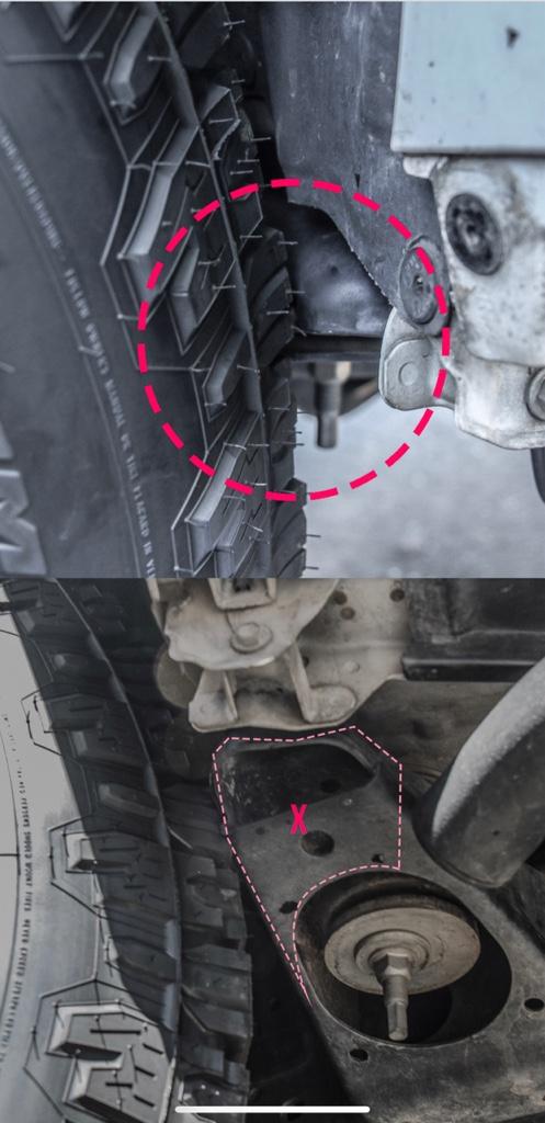

I would look out for crappy body mount chop work. When guys try and fit larger tires on a runner they sometime do a BMC. If it done poorly it leaves your frame susceptible to the elements and is not good for your rig.
