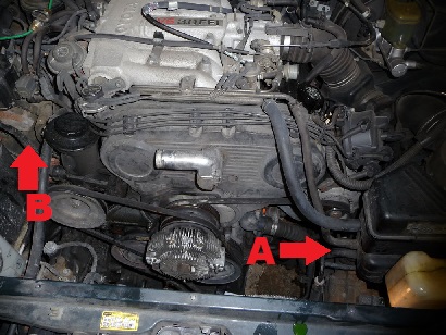

This is what you started talking about.
What is the purpose of the resonator, the black cube that's part of the air filter housing aka Air Cleaner Housing?
It's just 2 tubes going into a plastic box, and it's after the filter.
In the pic below.
Are you asking about (A) or (B)?
Because we started with (A).
:suspicious:
(Pic not of my engine. Found it on google.)
Yes, A. But there's 2 boxes there, and this is the upper one, that has it's input coming across and around the top of the air cleaner. I'd put in a pic, but mine's in more than few pieces right now.
That description was from EC-26 of the '92 FSM.
Separately, the main airflow from the air cleaner that goes straight back and then to the throttle body goes through a "plastic section" just off the air cleaner before going into the tube that bends around to the throttle body. It seems like that part is more fitting to the description Antman posted, and maybe was also a resonator of sorts. But looking a second time at the FSM, maybe not as I can see a path to the intake too.
Either way, I think we're good. It's pretty simple and should hold up, as long as it's not it with fan shrapnel. I'll grab one when I head to pick-n-pull.
