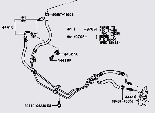

The pressure hose is quite large.
LWR return hose

Is there any reason the return hose can't just be replaced with a 3/8" hose entirely? It's low pressure and both ends are attached with a spring clamp anyways.
For the supply hose, it's high pressure, but similarly, is there a reason why you couldn't get two end fittings and crimp it onto a full section of hydraulic hose (that is properly rated)?
This would remove some of the complexity in having to work around all the bent lines.
Return line can be replaced with anything. I got my high pressure from member parting out for like $80.
