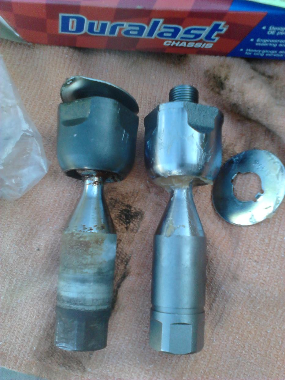

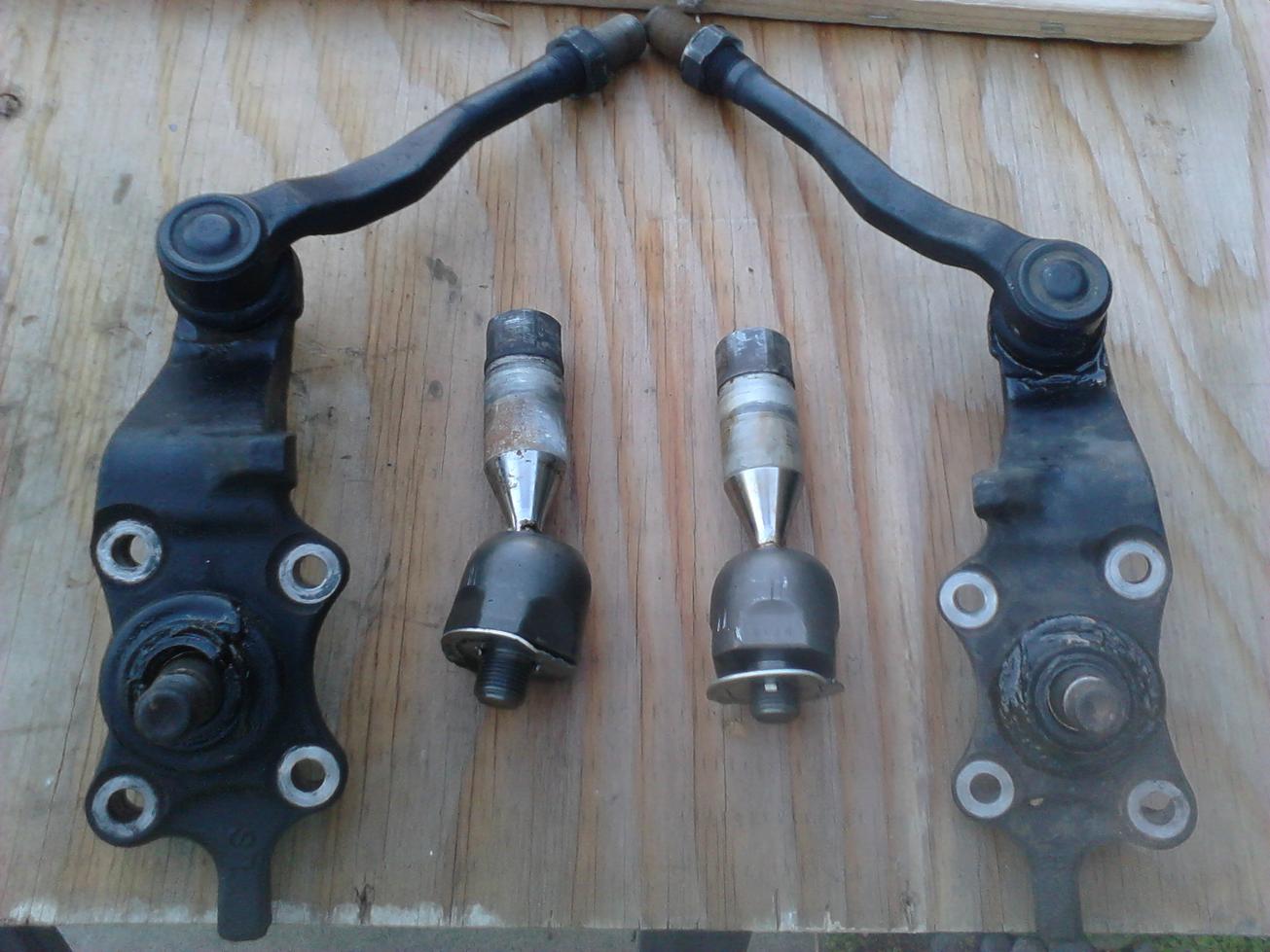

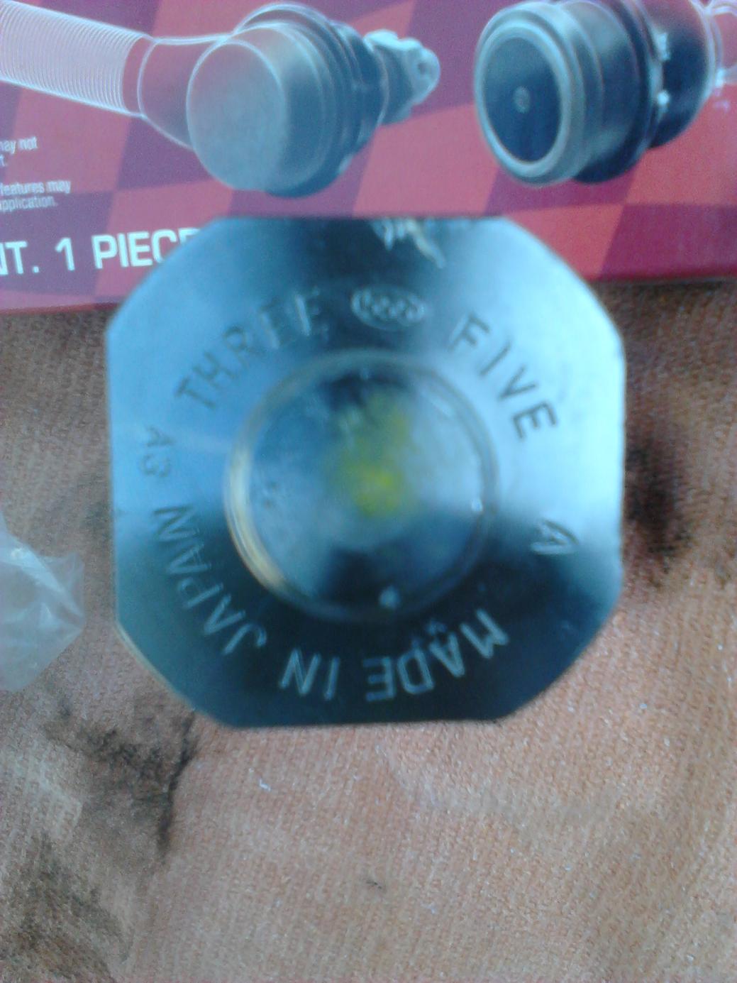

I just changed my last week, used OEM LBJ and OTRE, but when I took everything out the INNERs were bad, so went to autozone and found out INNER was from 555 made in japan $30 each.
could you tell me the part number for those inner tie rods? from autozone? thanks!

Sankei 555 is NOT oem. Sankei 555 is often re-branded as Raybestos, Napa, Moog, and etc. I made another thread with my findings on lower ball joint manufacturers and why OEM is best. Im not sure who makes the OEM lower ball joints, but there is a noticeable difference between those and the Sankei 555.
