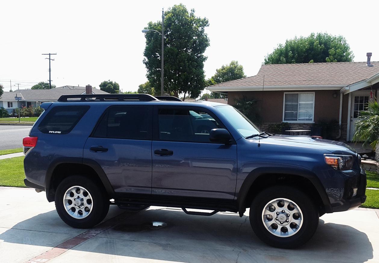

Bilstein 5100 adjustable in front set to 0.85 for almost level with a slight rake. If you set them to 1.75 it's level and looks good. But you may need Airlift bags in rear to keep it from going negative when loaded. I did 0.85 as in photo but wish I had done 1.75.
