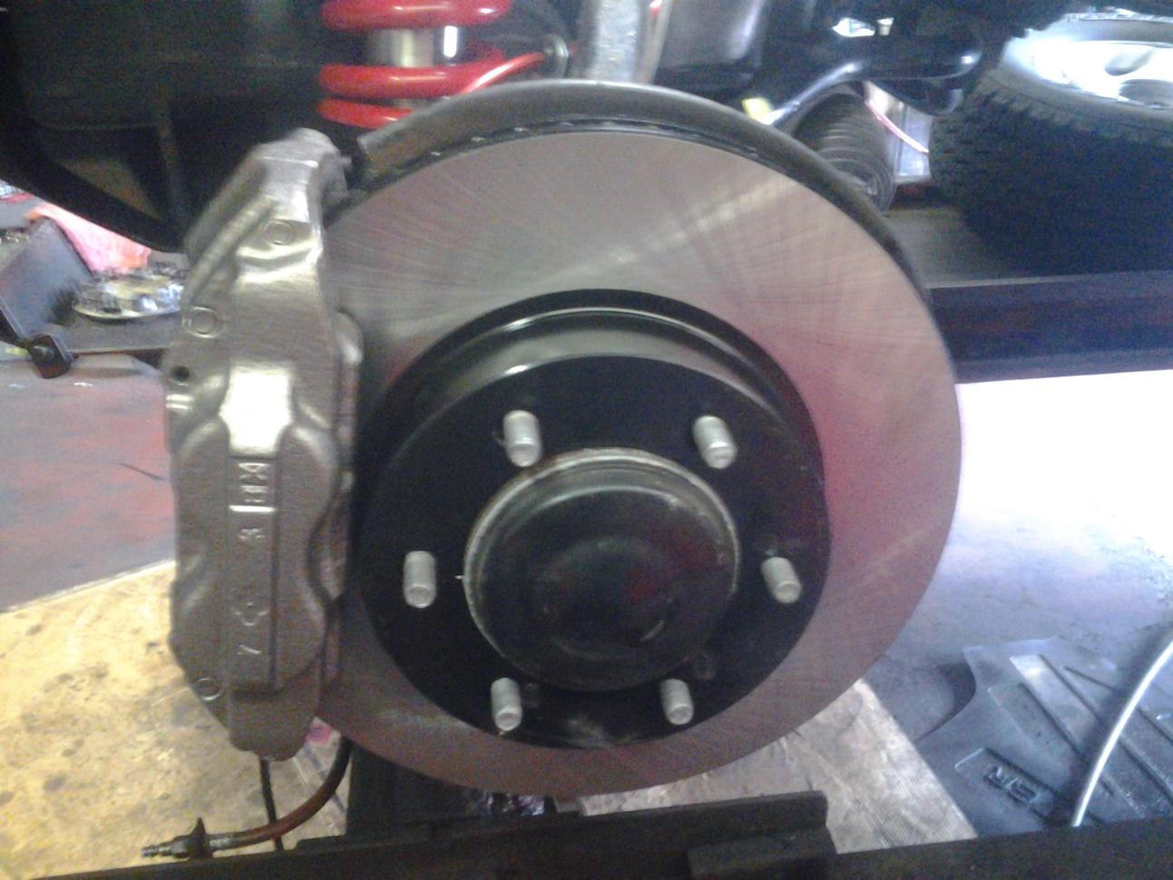

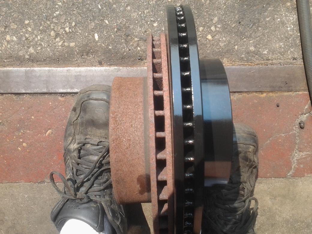

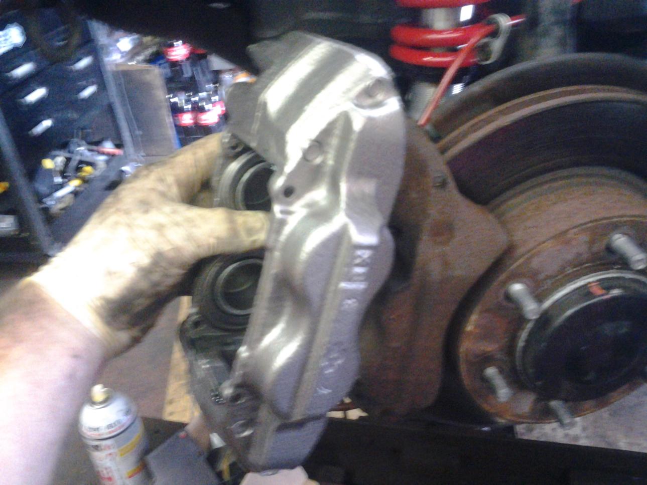

Both the 199mm & 231mm are a direct bolt on. But with the larger 231mm calipers i had to trim the backing plates a lil bit to clear the calipers. I just used a pair of tin snipes to do the minor trimming. I have the 199's on my 2000 4runner and the 231's on my 1st gen 2004 tacoma. Best upgrade for the buck imo. I ordered my tundra brake parts from a parts warehouse that my work uses.
