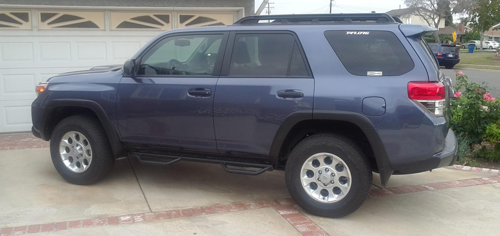

0.85 will get you close to level with a little tail high. 1.75 will give a good level. If you load it much it may go tail low at 1.75 unless you add Air LIft bags. I set mine to 0.85 as in the photo and think 1.75 may be better.

Here's a 14 TE set at 1.75" (Corrected from initial 2" claim) on the fronts and just the shock upgrade on the back. Fenders measure 35" to top of front and rear with a couple hundred pounds of gear in the back. But visually it does look slightly tail down.

Here's a 14 TE set at 2" on the fronts and just the shock upgrade on the back. Fenders measure 35" to top of front and rear with a couple hundred pounds of gear in the back. But visually it does look slightly tail down.

My mistake. Both struts came in the box with the adjusters set at 1.75" and I moved them to the next higher position. So I must be set at 2.5". Thanks for the correction.

My bet is they are set at 1.75" or else you'd be really front high, enough that it would look like a trophy truck. 1.75" is almost dead level until you put one bag of groceries in the rear.
DING DING DING, PAY THE MAN DAMMIT!!! I would have sworn in court I had them at the top ring, but a visual shows I have one more up to go. I guess I should be glad I got them where they are. It took 6+ inches of down adjustment to get my headlights where they should be. Thank you for THAT tutorial!
