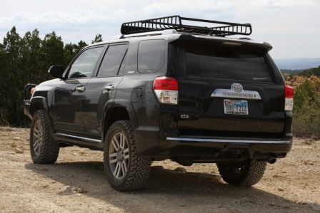

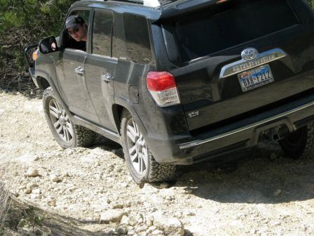

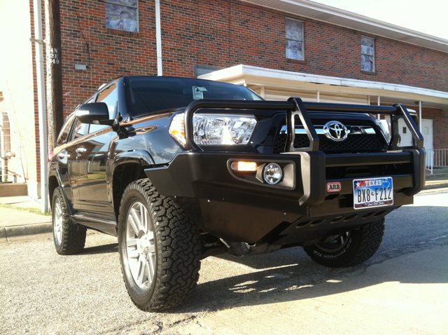

I have Bilstein 5100s all around with no lift and BFG KOs 285/55/20s. Early on they rubbed a bit when turning, but I think the tire won the battle with the plastic. :)
I removed my XREAS as a part of this project. It's not that hard at all. Mainly it can be a bit messy if you don't open the valves on the shocks VERY quickly (it will spray everywhere). Also, you need to remove the lines with the side you are working on jacked up, to reduce the fluid pressure on that specific shock.
