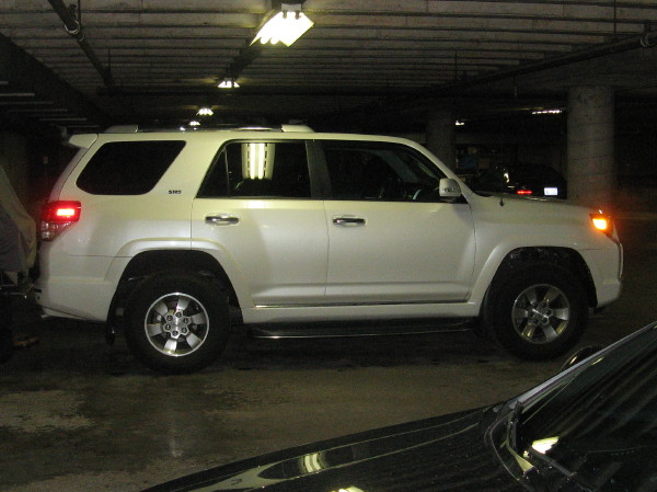

I sincerely apologize for the confusion and have edited that post to correct it. As pictured there is a 40 pound tool box and about 100 pounds of personal gear in the cargo area over the rear axle. I have yet to take a picture of it unloaded to see what it might look like. I went with the settings I did after seeing ChrisTheSwede's 4R with 1.75" front/0 rear. His looked like the rear end was slightly taller than the front and he admits to a slight forward rake when it's not loaded. I honestly thought I had gone 1 notch higher to cover that rake, but I guess my normal work load is doing it for me. You might try measuring from the ground to the upper center lip of your front and rear fenders to see what the difference is.
3wb, nothing to apologize for. You originally said 2" in front, which isn't possible, but it's still not .85, so that's what threw me. I have the sliding cargo tray (which I find totally useless) and I keep a set of jumper cables, a couple of towels to throw on seats for wet or sweaty kids, and an umbrella. 99% of the time, that's all that will be back there other than a week's worth of groceries. I'd prefer no rake but would rather have a slight rake than a noticeable reverse rake. I'll communicate that to my shop when I have them install the shocks and tires.

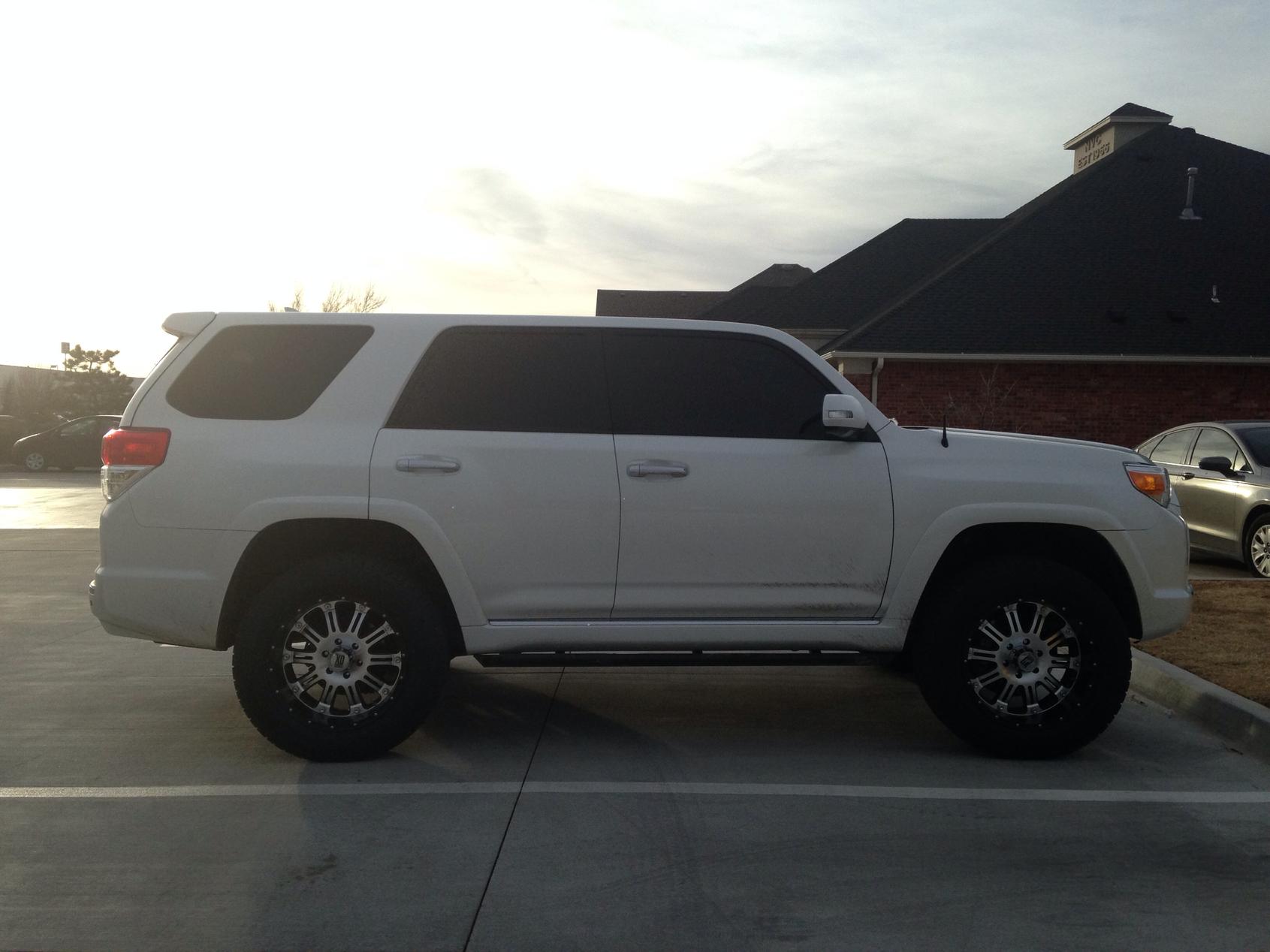

2.5 front 1" Cornfed driver side only looks like this and has 5/8 rake.

I agree with [MENTION=85512]eddiebx[/MENTION] (just this one time). I used .85 to get rid of almost all the rake, but I wanted to keep just a tad of rake for when I put a lot of shite in the back, which I do. Works for me.
