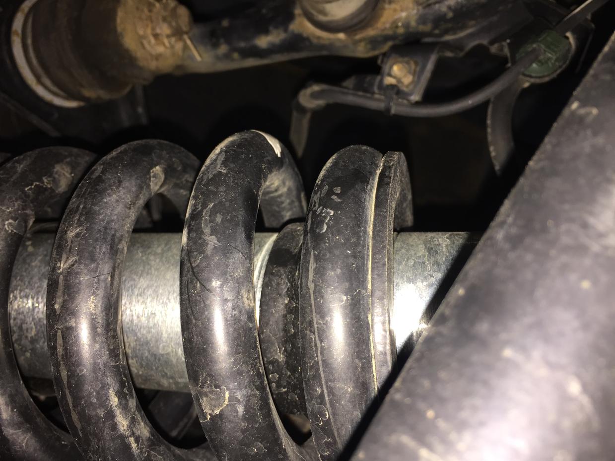

I recently had a guy at a mechanic shop help install bilstein 5100s on my sr5, front and back, with a daystar 1.5" spacer in the rear. I wanted the 1.75" setting for the front. For some reason I think that maybe they went to the .85. Can someone look at the pics and let me know what they think? I can't tell what notch they went to. I dont' want to deal with those guys again. I was super clear on which setting I wanted. I didn't expect such a large rake.

hard to tell but it looks like they went to the 3rd notch. Even at 1.75" you would have rake with a 1.5" spacer. I have the front set to 2.25" and a 1.5" spacer out back and it is pretty level.

Just installed mine last weekend and it looks like they went 1.75" .. one notch from the top from the way the spring is seated. Rake looks about right as well for the lift. You would have a lot more at .85

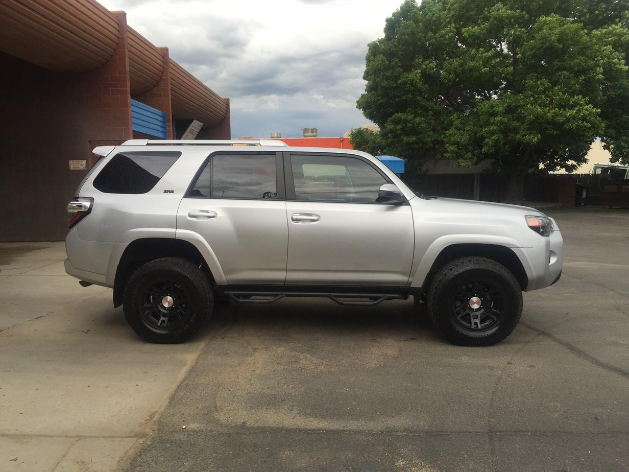

yes, but only 1" cornfed spacer in the rear, its tough because everyone pictures almost look different from all the angles heres another one of mine from the front

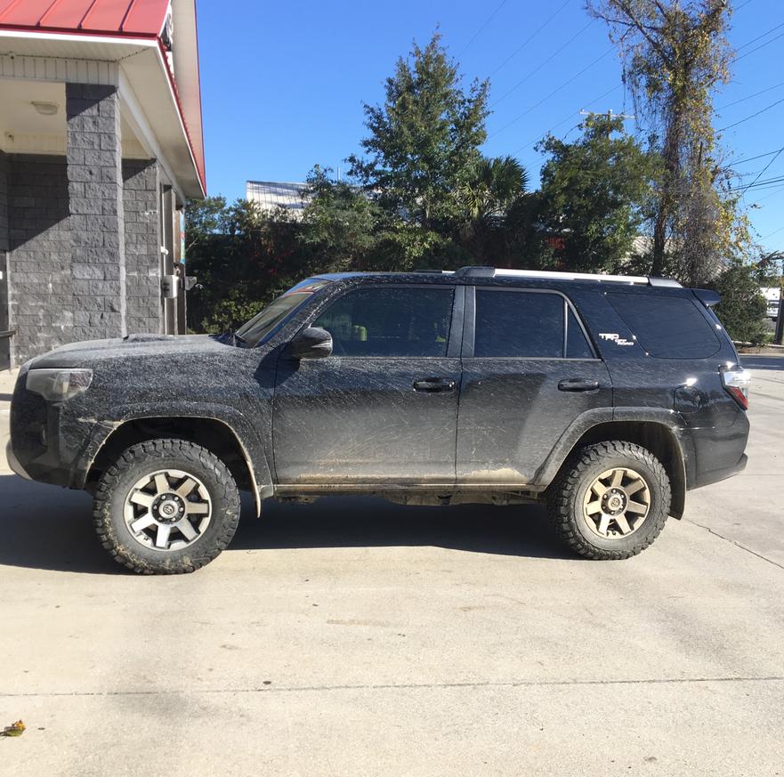

I have 5100s all around. 1.75 up front and the back I added 1 inch spacer. Sits just like factory but taller. I am impressed. Haven't towed anything just yet though.
You can see my pics in my album.
(dont know how to rotate image. left side is top. There's one notch exposed as you can see.
1.75 front and 1.5 rear is not gonna do much for the rake. I have 1.75 front and .8 rear (2x 10mm spacers) w/ KDSS and it still has a slight forward rake. If anything, change the setting to 2.25 on the front.

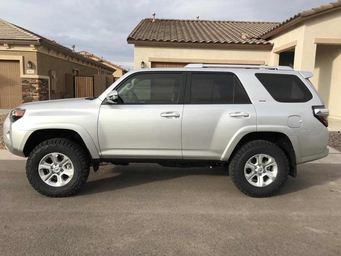

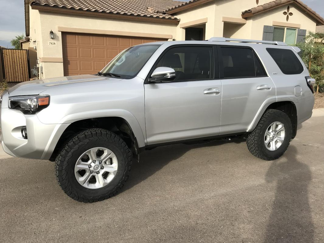

Here’s more pics just for reference. Billies on all 4 with front set at 1.75. No rear spacers etc...
Very nice! Thanks for the post. This is the exact stance I'm looking for on my 2016 TEP. Don't want to hijack this thread but what size tires are those...if you don't mind me asking?
Stock size. 265/70 but on bfg ko2’s. Anything larger would probably just look even better.

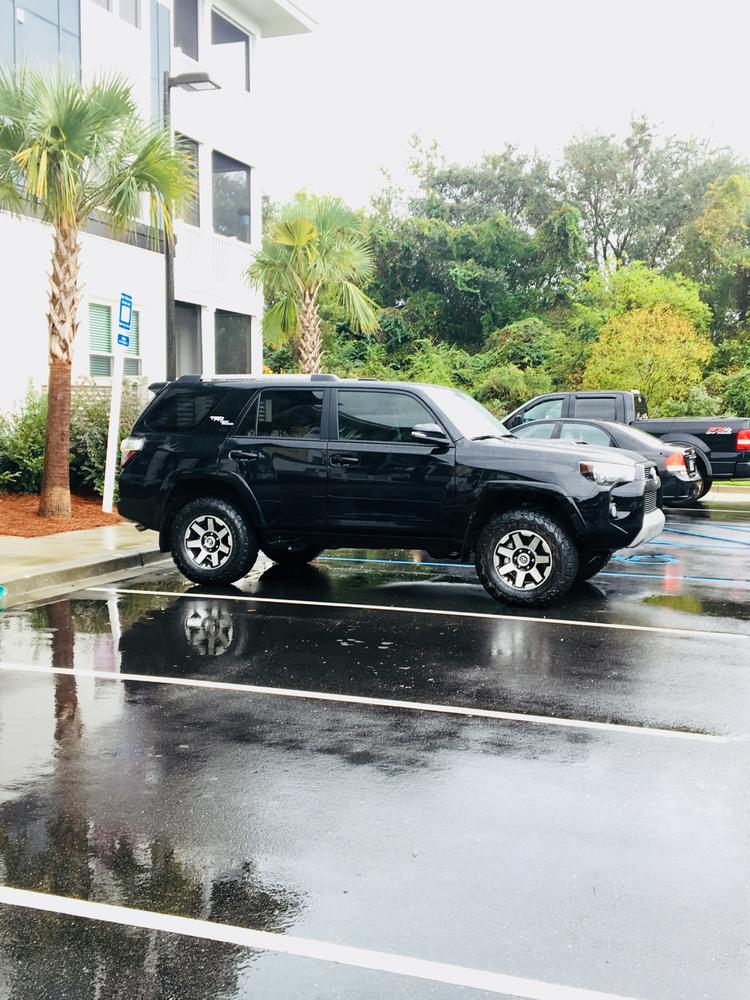

Added 4 5100s today and the front is at 2.5". Wishing I went one notch down from 2.5" and I would be pretty level. Tires are 275/70/17 on stock wheels.
