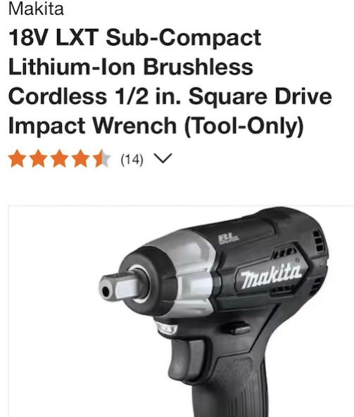

Looking for some input on this Makita 1/2 inch socket impact. First reason being I have a few 18v batteries already and other tools in the line.
Would this be strong enough for brake and suspension work on the 4R? Hoping to do more of my own work this summer.

Im confused by the pic. that looks like the impact driver but is labelled as wrench. which is less powerful than the impact wrench. if you need high torque I think you're going to want the impact wrench. the impact driver is better for hard to reach areas that don't require as much torque
I think for brake and suspension work you want the wrench with more torque.
either way makita is one of the top brands just make sure you're getting the right tool (driver vs. wrench) but honestly if budget allows get both and invest in your DIY tool set if you plan to use it frequently. never underestimate having the right tool for the job lol , it can save a lot of headache . sometimes you need the wrench, sometimes the driver

Thanks Humble Leader, it is the wrench (or labeled as the wrench):
Model techology LXT XWT13ZB
18V LXT® Lithium‑Ion Sub‑Compact Brushless Cordless 1/2" Sq. Drive Impact Wrench, Tool Only

interesting, I see makita also calls it a wrench but I've seen that before on their site under the pictures of impact drivers. this is the wrench I was thinking about
DTW301XVZ - 430ft lbs of release torque and 200+lbs fastening
Yeah, more power and only $29 more. Thanks for sending, this is the model I'm going to research and probably go with.
Or another step up to the XWT18Z: 520 ft.lbs of Fastening Torque and 740 ft.lbs release < that should be all I ever need I would think, applying a good penetrant for anything older or rusty/corrosion, but we try to avoid that as much as possible.
That particular Makita has barely enough power to do much of anything, much less bust loose a rusted bolt. If you're going to spring for a Makita impact, at least go for the XWT08Z with 1180 lb-ft of reverse torque.
the XWT08Z isn't that much more and special deal with free 5ah battery and charger.
