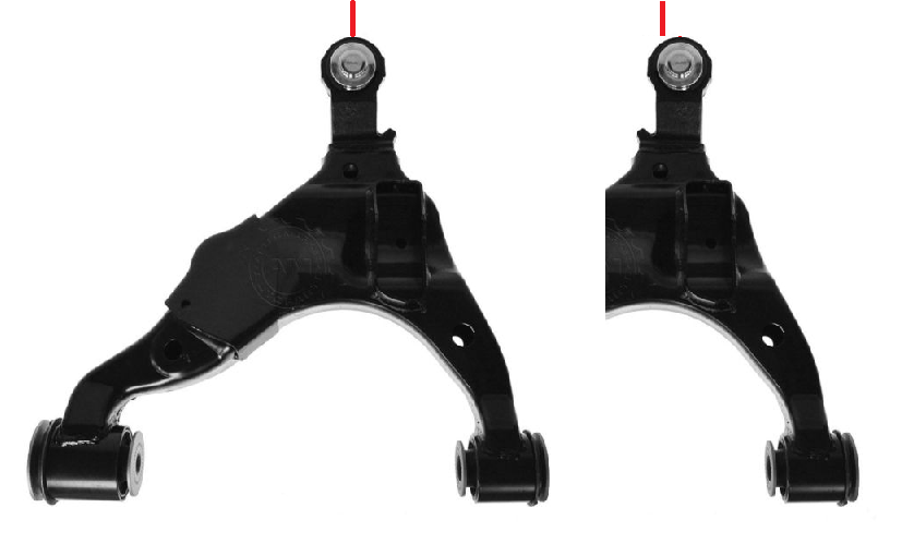

For those who've run 35's with stock front control arms - what are your thoughts on this?
I've been kicking around the idea of 35's in the next year or two for offroad but don't really want a LT setup.
I have a CNC plasma table and fab equipment. I could probably make a LT set of control arms in a weekend. But that's not really my goal here. I like to take the easy way if it makes sense. I'm thinking about what it would take to tuck 35's in with minimal lift and minimal mods - but also have full range of motion and functional use. Not a show truck.
So... as I see it, I need to relocate the lower ball joint forward to make clearance in the rear. Then I'd start chopping on the front bumper cover/fender liner to fit.
My thought here is to not reinvent the wheel. I'm thinking about taking a set of OEM LCAs and modifying them as shown in the picture. Basically just cutting out the ball joint forging and reversing it side to side. (Don't worry - it ain't my first rodeo, I mean cut the welds out carefully and weld it properly back in- not stick the thing in a band saw and hack off the end and try to weld back a forged suspension part...) By my estimate I'd relocate the lower ball joint forward around .75 inches. I'd also have to modify my UCAs to probably relocate the ball joint back to near where the OEM ball joint used to live to get the caster back in spec. Potentially I could actually just use the OEM UCAs again.
Thoughts? For folks running 35's - do you think this would make enough clearance to solve most of the issues around the BMC/fenderwell area? It seems like .75 or so of extra clearance would solve the biggest issues with rubbing. The front should be a bit easier to make the necessary room from what I can tell.

Just trim your fenders 3/4".
Building LT uppers/lowers is way more then just cutting some sheet metal and welding it together. But have at it.

I think the BMC would be a must-do either way. But I don't think it's usually enough to fit 35s anyway. It's more of the fender/firewall problem. For me, designing and manufacturing control arms is pretty easy. A lot easier than having to finish body work properly. I have all the tools to cut and form steel plate. I don't have a paint booth. :(

I️ have taken my fenderwall back about 2” to make clearance for 35s without rubbing. I️ still hit the body mount when I get really rowdy (chopped as much as I️ possibly can). Note that I️ use steering bumps to keep from hitting my secondary bypasses up front, so 2” fenderwall cut might not be enough if you have full turning radius.
if you could move the wheel mounting surface 1" forward, you could do whatever you wanted. thats partly why the LT works so well, all the companies moved the ball joints forward about an inch and a half.
the problem you'll run into is that without moving the upper ball joint forward as well, you'll be ****ing with the caster A LOT and your dive/anti-dive will be jacked.

Yes, too much work and cost to avoid spending $1500 on Dirt King's LCA with no extension of front wheelbase, or ($2500?) TC LCA with 3.5" increase of front wheelbase. If you have all those tools and that kind of talent, do what you're good at for money and buy what's already been developed for LT.

I'm pretty sure that won't work. Using a fabricated upright to move the spindle center forward will cause geometry problems throughout the turn radius. You really want to keep the spindle on the axis of the pivot between the ball joints.
The ideal way to move the tire forward is to move the control arm mounts on the frame. The second best option is to make new control arms. Moving the spindle on the upright is something I would steer clear from. I don't think it'll be drivable unless you do some crazy stuff with the steering arms.
The biggest fitment issue I see is the axle shaft interference with the shock. It's not terribly hard to move the lower shock mount enough to make some space. The other option is to relocate the diff forward a bit.
For an example Big Mike's (Marlin Crawler) Tacoma has 37's without cutting the firewall and will be on 40's. He has the All Pro LT system but asked them to adjust the jig to move the ball joints forward IIRC 2 inches. Seems to drive well with 37's and that setup.
