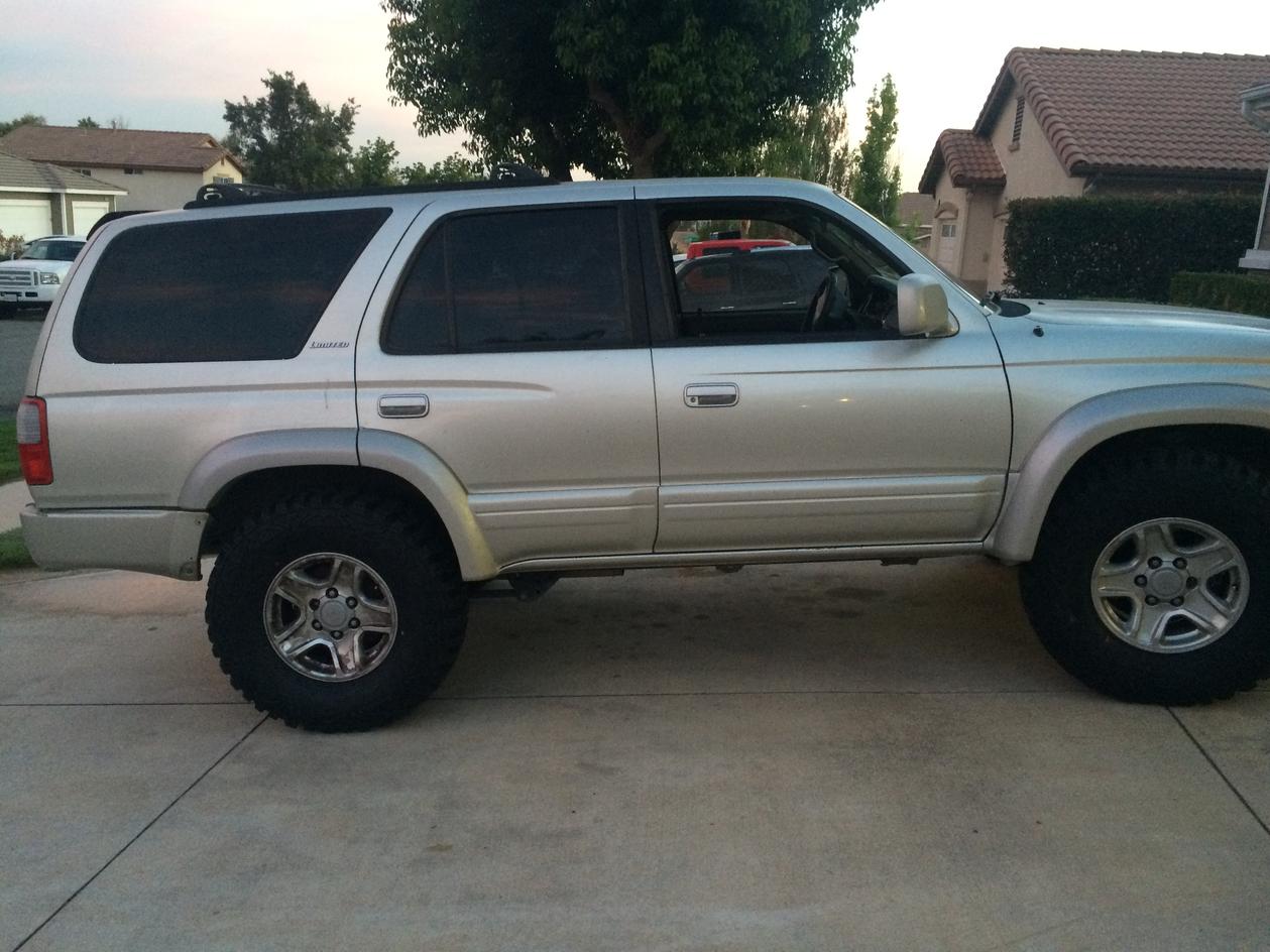

I have 285/75R16 Pro Comp MT2's with no lift or spacers. It will rub really bad if you are not willing to cut and hammer your firewall back a at least 1.5". I just cut off the pinchweld and some of the plastic wheel well. I didn't have to cut my firewall or weld anything but I did beat my my firewall with a BFH about 2" in. It doesn't look the prettiest but it doesn't stand out looking bad either. It will rub the UCA and the frame at full lock and occasionally rubs when offroading. It is definitely doable but its a little bit of work and you gotta be willing to cut and hammer.

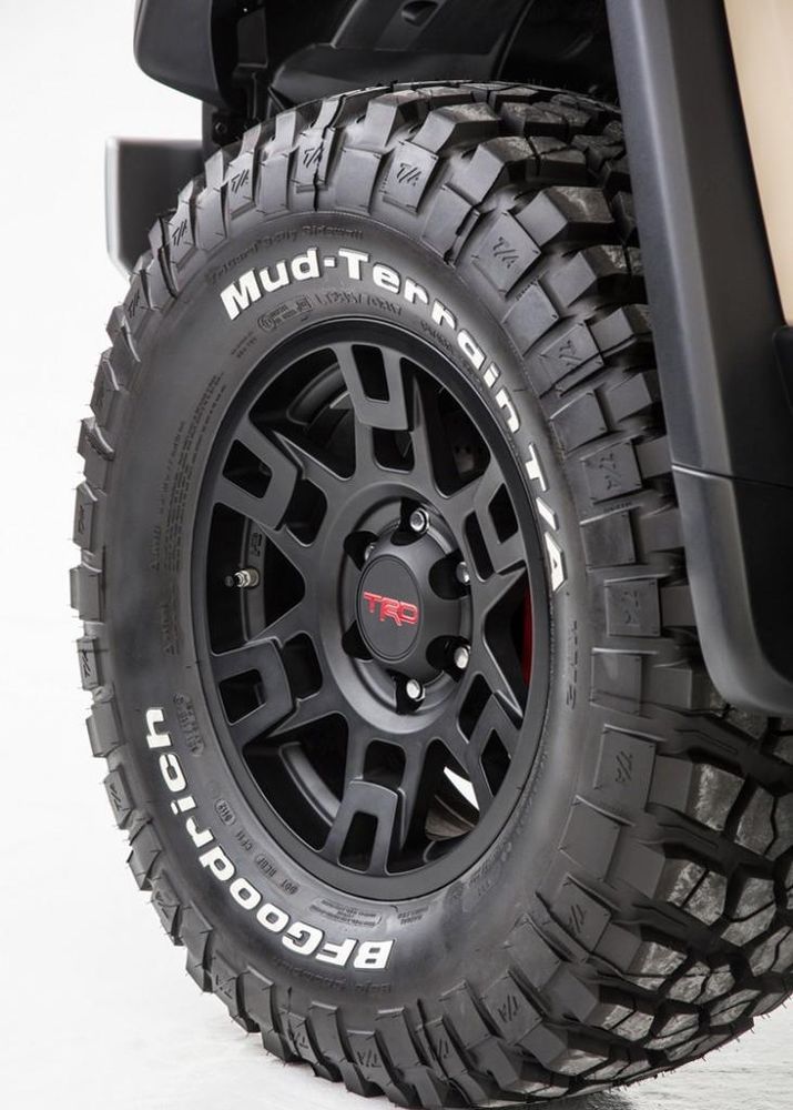

I am trying to decide on these two tires....both of course will be coming from TOYOTA TRD DIRECT FROM THE DEALER. I got a hook up. Which style do you guys like more?
LOL, we got a few of those, which rim should I go with?
The top one for sure! :thumb:

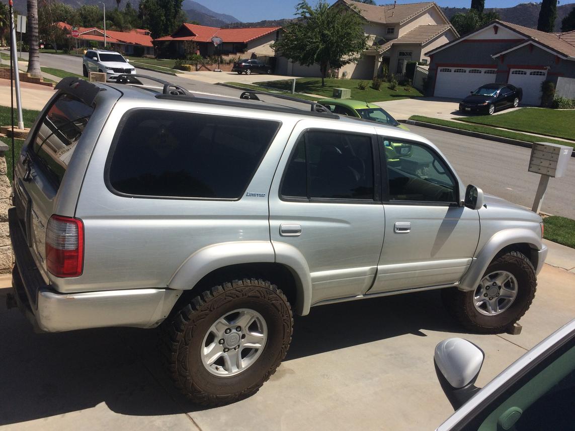

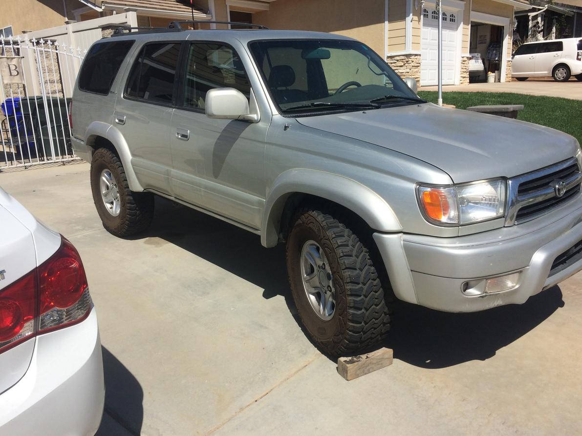

Here are some more pics. I suck at remembering to take pictures when offroading. Usually having too good of a time to stop to take a picture
