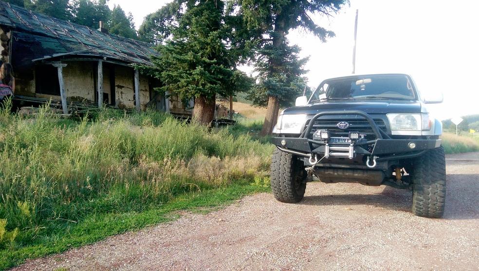

Its all about the 305/70r16. I rub a little, but its well worth it. Ive been able to pull 19mpg on a 1000+ mile trip, all highway, no mountain passes. The look just sets the truck off. I like em thick, never was a skinny chic guy!
