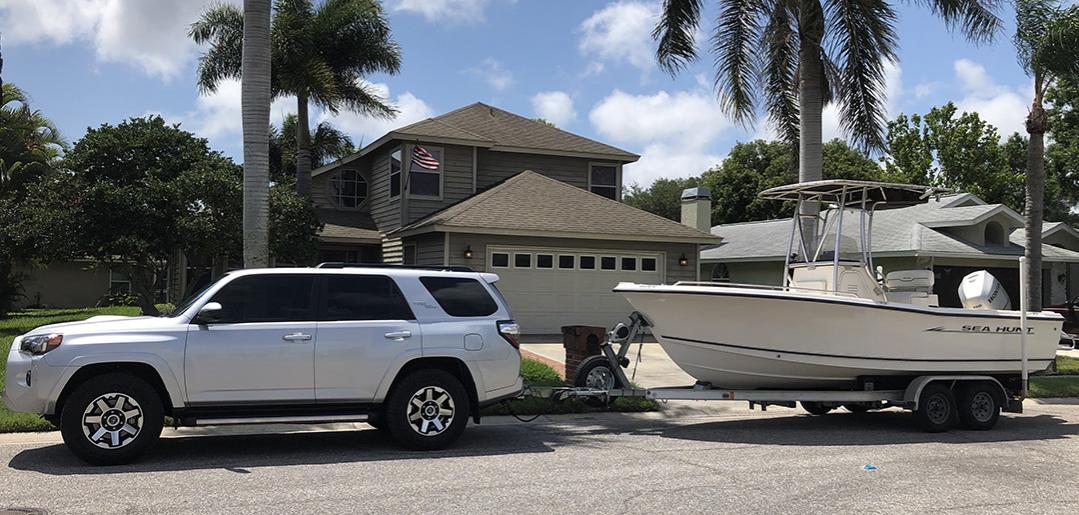

I’ve had my 20’ boat for 15 years and hauled it with 5 different vehicles. The T4R isn’t the worst, but it’s certainly not the best at hauling.
My trailer completely loaded with the boat, all the fishing crap, trolling motor and a full tank of gas is 4,260 pounds (certified truck scale) with a tongue weight of 298 pounds. My suspension is completely stock. The rear drops about 1 1/8” with the rig hitched up and looks about level with maybe a tiny bit of rake left.
I realize that travel trailers are completely different than boat trailers, but the level kit is really hurting you. I would probably start with airbags on the rear then consider a WD hitch. Best option is probably better springs, but that may end up making for a harsh ride when not hauling. If you want to solve a lot of the problem go back to the stock rake.
