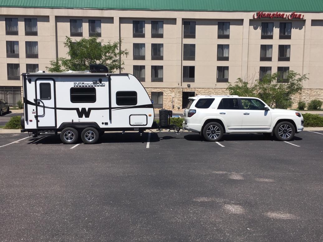

Here’s a pic of my setup. Trailer weighs about 4K pounds all loaded. Very stable on the road, balanced and no airbags, non stock springs, etc. If you want to make a more important mod, I’d add a transmission oil cooler.

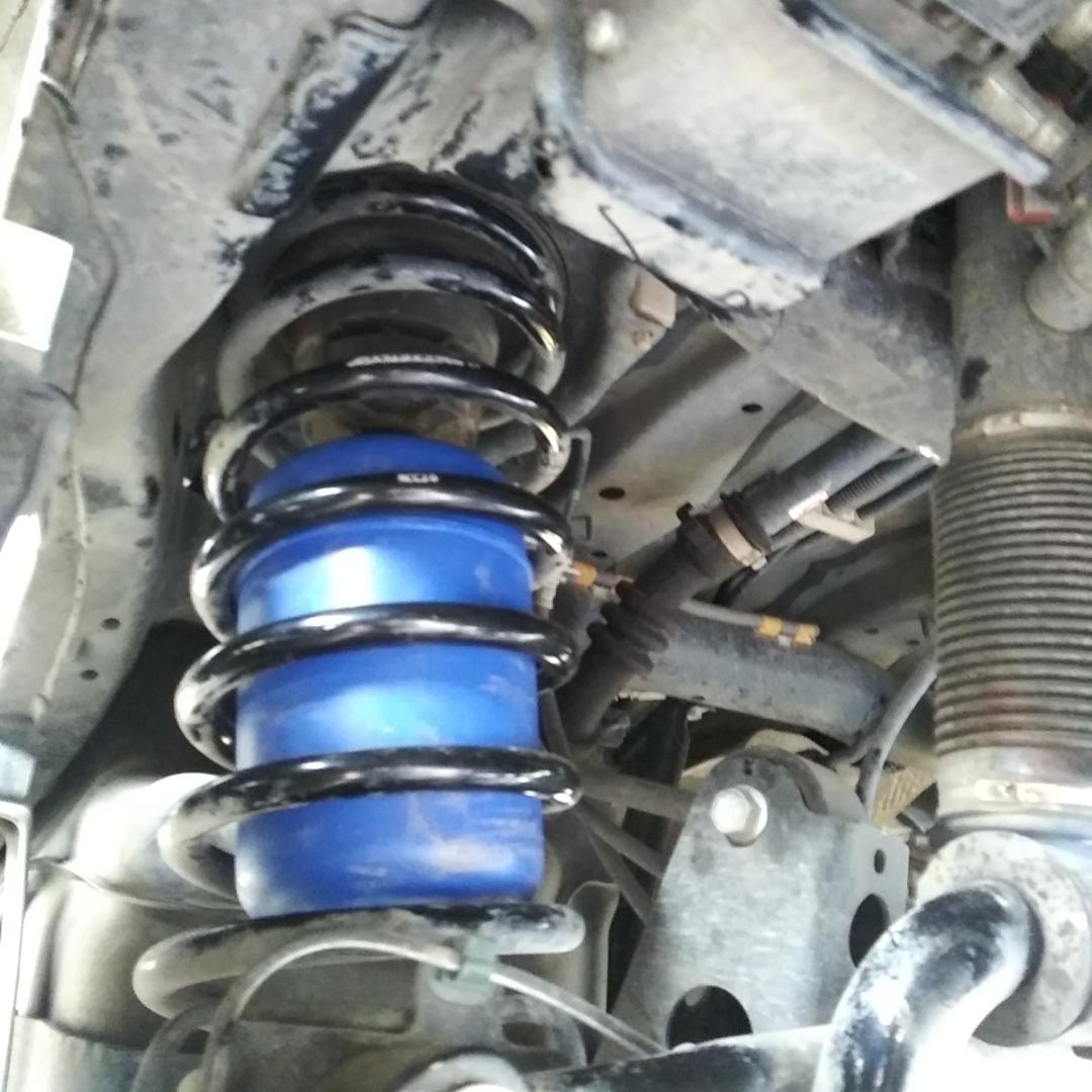

Firestone Air spring helpers 1000lbs rating.
i just installed these took 2 hours. $100.00 on Amazon.
what a difference, just got back today from a 1000 mile trip made it solid as a rock highly impressed. i also suggest a re curve 3 weight distribution hitch it is the bomb.

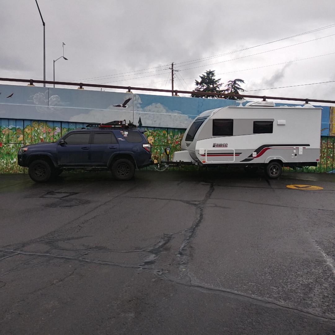

Hooked up the trailer and ran it home to get ready for an outing tomorrow.
I am very pleased with the new springs.
They are just the ticket.

i have just ordered an inch taller rear spring that should be arriving in a couple days and because i was going to have the rear springs out, i decided (what the hell) and ordered the firestone helper bag kit and will be installing that as well
