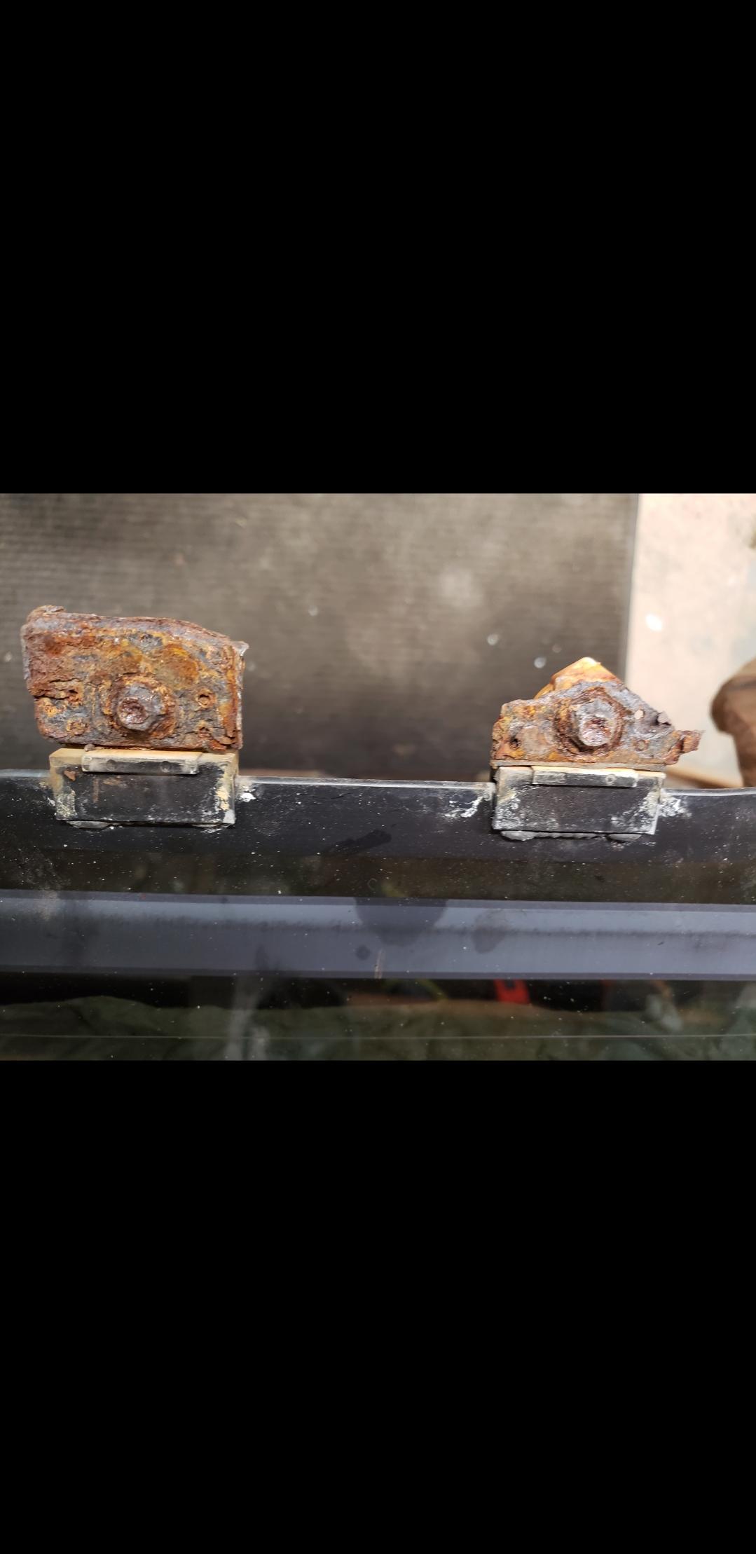

Looks like I'm most likely cutting these out. I have them soaking in PB blaster for the night to see if that helps. I did break one of the window tabs pulling the glass out. Just the bottom part broke off. I'm thinking I can jb weld it back on.

Yea those are pretty nasty. Good luck

Glad to hear that. I was able to just cut the bolt heads off of all of them. I did break one additional tab. So... I now have 1 broken tab on each side, and just 1 good one each. I'm currently trying to epoxy washers on the broken ones to see if that works.

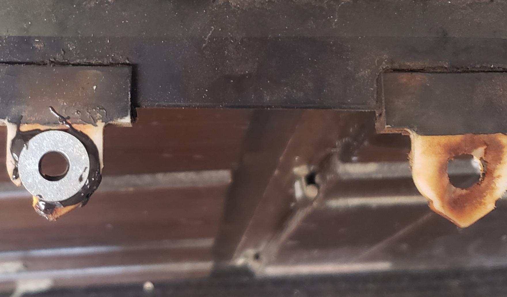

Just to follow back up on this, I've got the window back in and everything works. There was no way I was getting the bolts out of the glass tabs with a socket as they were just too corroded. I cut the tips off with a dremel, then cut the heads in a cross shape. After that they pulled out. 1 tab had already broke, but I did break 1 additional tab on the glass. I jb welded washers to the back side of the broken sections , and that seems to have worked.
