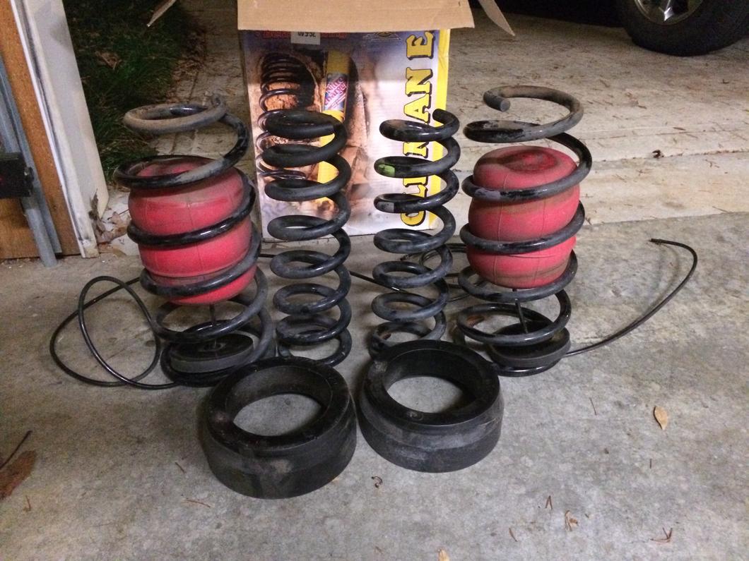

I have ordered Bilstein adjustable shocks with matching rears from 4WheelParts (by the way $275 OTD :clap2:) and am planning on lifting my 05 Limited. It has XREAS so I am planning on replacing it and getting some lift out of the Bilsteins. I also have FJ Springs thanks to @dougiefreshmx which I am planning on using.
105639d1387765958-fs-fj-4x4-coils-w-airtlift-fj-fog-switches-w-harnesses-1-5-spacer-clt-nc-img_2499.jpg~original

I also remembered that, as pictured, I was able to acquire the 1" airbags for the rear suspension. I would consider using the airbags if anyone thought it would be a good addition to the setup. Thanks!

You don't really need the airbags if you're not towing or loading up the rear.
