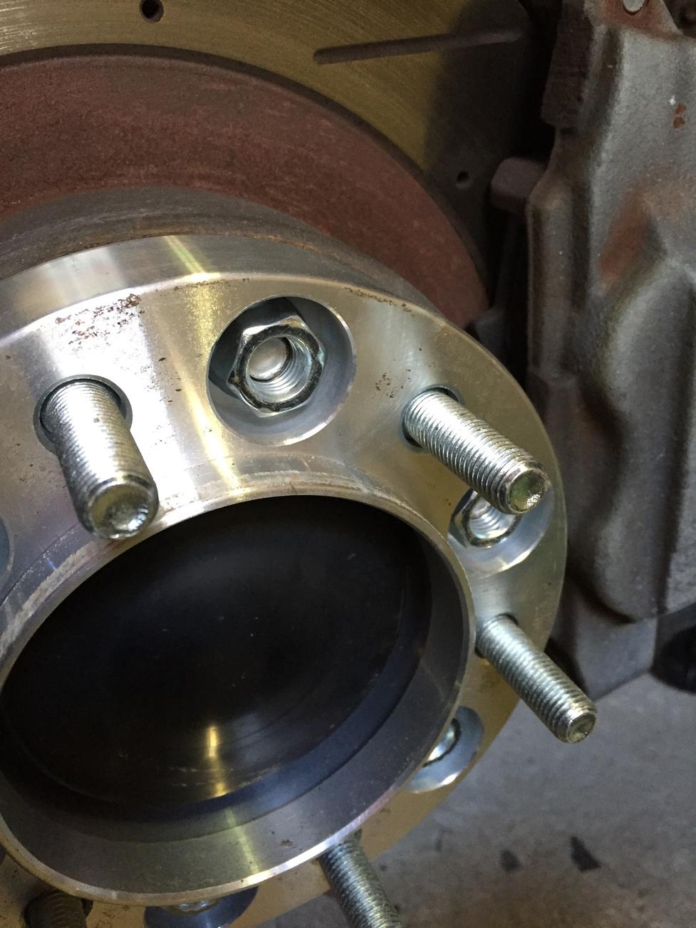

Nice! :rockon: Did you have any issues putting them on the fronts? I also bought ebay spacers and did not feel comfortable with the bite I got from the lugs on the front. Only had about 5.5 turns, not enough for my blood. I ordered longer studs.
Have not installed yet but I will report back once I do.
