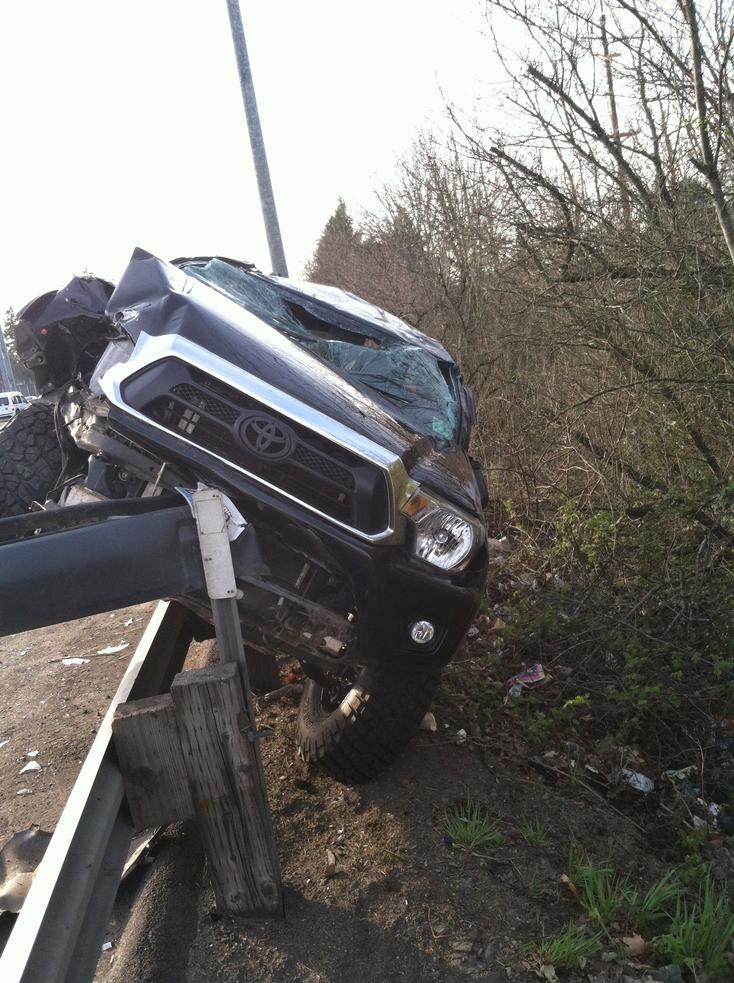

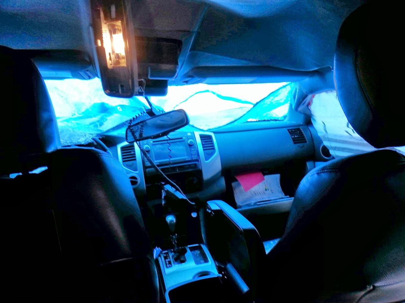

Here is a picture of my old Tacoma that I flipped 4 times with my 4 yr old son in the car. Not distracted during the driving, but people's inability to merge was the result of this. We walked away with minor scratches (took my son in and had him x-ray and looked at head to toe, but he was 100%). I actually was thinking this same with with my new 4runner I purchased and since it's modified it has me slightly worried. I will be putting a roll cage inside but I do know from others after market bumpers tend to provide a little more rigidiness =D
I'm very conservative in how I drive and put lots of space between myself and others (even did that before that happened) but unfortunately sometimes things happen..
