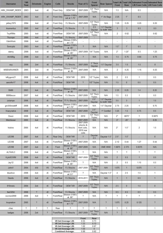

If I wanted to do the swap to fj springs, would I need oem fj springs or could I get like autozone replacements or something? Also, a set of fj wheels for sale in my area for 475. Good price or no?
Any 4Runner replacement will work. I originally put FJ coils on my XREAS shocks and a lot of guys use FJ coils with the Bilstein 5100 replacements for the 4Runner.

And also, what year would be the best? And how much of a lift would it give me?
Okay so they'll work with my stock stuff right? I have an 04.
Yes sir. I netted 1" up front and 3/4" in the back from the FJ coils alone. I added a 1/2" thick spacer up front for an additional inch of lift to level it out.

My question is, if I buy FJ coils, will they give me additional lift? My initial thought was yes it will.
Agree/disagree?
Agree/disagree?
Short and sweet, yes they will, about 1/4" to 1/2"
depends how many miles on em, if you look at the chart in link above it will show just how much can be gained by the fj coils.
