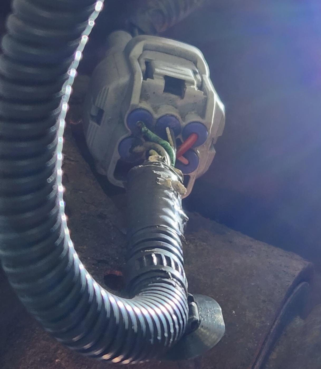

R randyjohnsonstl New member Sep 28, 2022 #1 2007 4runner. The ec1 connector has a broken wire. It's not easy to access, I've been fighting how to unplug it for hours. Would appreciate any helpful guidance on unplugging this. Attachments 20220928_140859.jpg 111.3 KB · Views: 200
G gookies New member Sep 28, 2022 #2 Try spraying some silicone spray on the plastic, should make it easier to unclip.
R randyjohnsonstl New member Sep 28, 2022 #3 Ok, I sprayed it well. Will leave overnight to hopefully soak in.
O OopsIBrokeIt Member Sep 29, 2022 #4 Press the two halves of the connector into each other slightly, then hit the button and wiggle it free.
