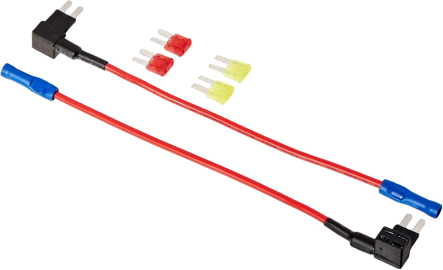

This wiring in these is so damn tidy. Is there an easy key on wire to tap into under the hood for a fuse block?
Right now I’m thinking about making a quick connection to the 12V power source, and run a 12 AWG wire out to the relay for the fuse block.
Figured I’d ask here if anyone knows of a quicker/better idea.
Thanks!
I used one of these on fuse number 18 (SEAT HEATER 25a):
Amazon.com: Uriveusa 12V Car Add-A-Circuit Fuse TAP Adapter Fuse Holder with 10A, 20A Fuse [Upgraded Fuses] - (2 Pack) (Micro2 Fuse): Automotive
