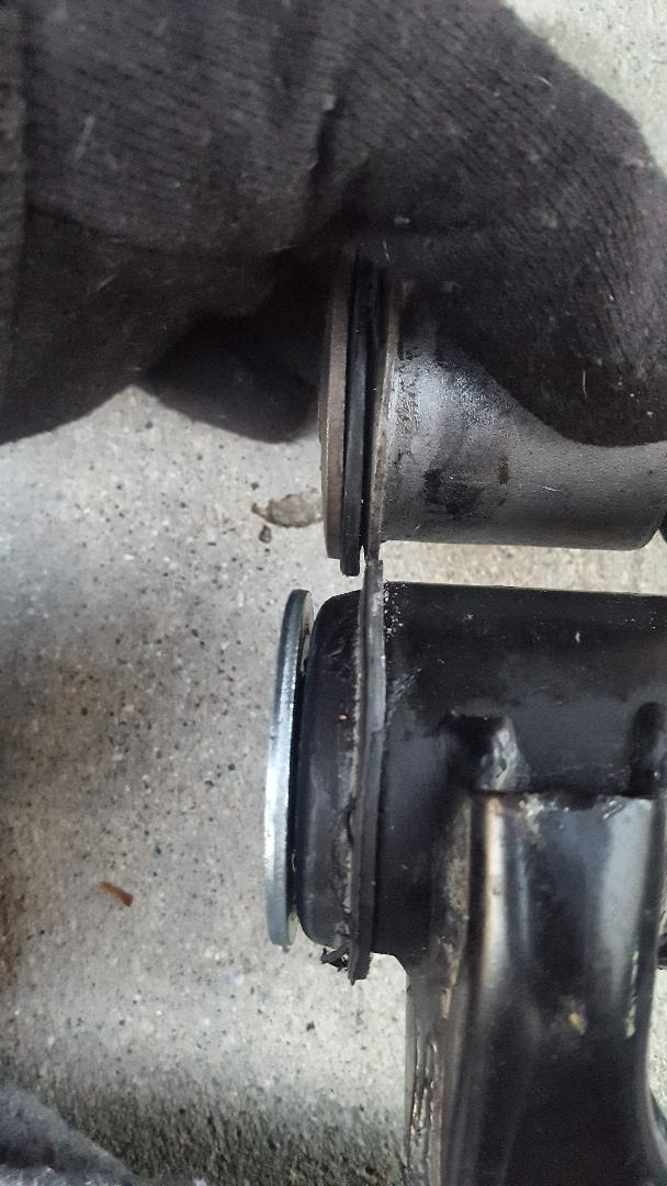

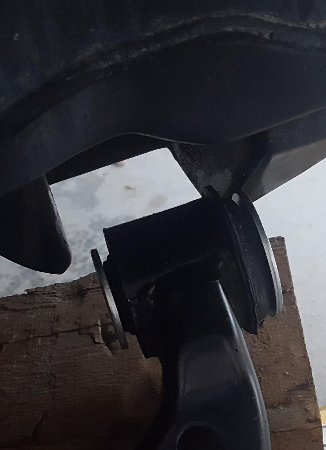

I had the same issue come up after replacing all the suspension, front and rear brakes, bled them, replaced the rubber lines, replaced the rotors and calipers again and still pulled dangerously under hard braking. It was scary to drive. Three shops had it up on a rack and couldn't figure it out. I finally took the shocks off and I found the lower control arm bushing was shot. It had less than 1,000 miles on it but it was toast. Must have tore it wheeling is all I can think of. Got the NAPA bushing but found it was too thick(see photos)so I went with Energy Suspension which I think is a better design as the sleeve, bushing, and washers are separate and can rotate independently.
Energy Suspension 8.3132R Front Control Arm Bushing Set
Pics won't upload, will add later
