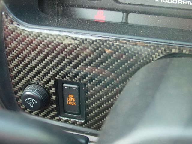

The factory Diff lock switch is located to the left of the steering wheel and is labeled RR DIFF LOCK. It is written in Orangeish letters and is not a rocker switch, just a button. Due to factory safeties, the locker can only be activated while the truck is in 4LO and is moving at less than 5MPH. If you are following those guidelines and it's still not engaging then you have a problem.
Here is a pic of what it should look like. (minus carbon fiber dash trim.)
