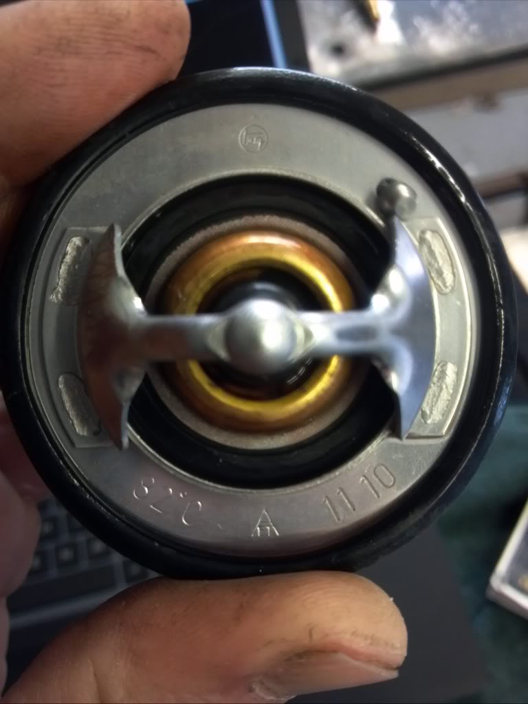

I was told that 218 219 is normal coolant temp and thats about the point where the thermostat starts to open up and dump the temp back down.
What/where is the:shrug: "Thermostat Jiggle Valve"?
It's a little port covered by a metal check valve. You can see it at about 2 oclock in this picture.

Jiggle valve up, I ran 198 to 204F, jiggle valve down (at 6pm)I run 186.8 to 190.8F and that's the usual range (defies my logic but I have seen it). As for the sudden and continuous rise in temp, I don't think it's normal and since you will be R &Ring the rad, you may as well do the fan clutch. If you wait until the dash gauge moves please let me know what temp it actually starts moving up at?
If the dash gauge doesn't move dont worry about it. You might need to clock the thermostat jiggle valve to the 6 o'clock position which will drop your Temps about 10*. http://www.toyota-4runner.org/3rd-gen-t4rs/186171-thermostat-fixed-running-cooler-now.html
