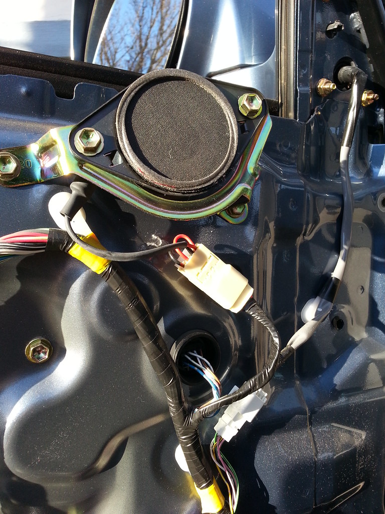

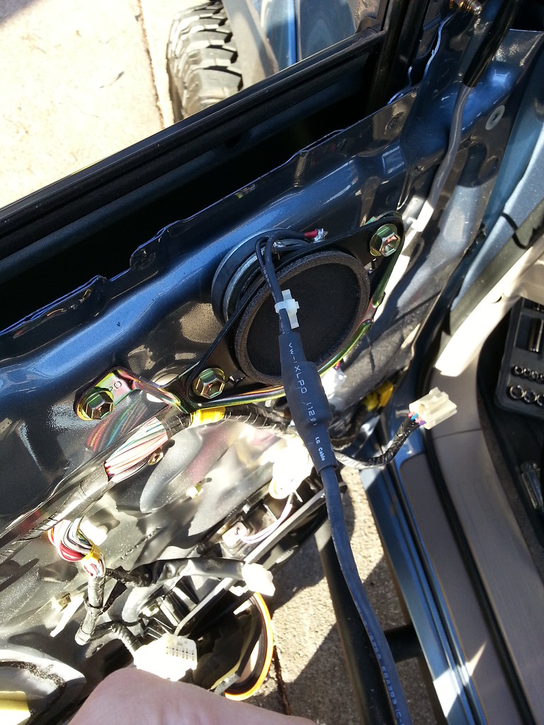

changing out my front speakers and i dont seem to have power to my driver side. I tracked the wire and there seems to be no power to it. i've tested the old speaker and nothing as well so its been dead for some time. Any help to where i can get power or how its supposed to be working? I have my door torn apart and dont want to put it all back together to tear it off again.
Pics
No power at the pink and no power at the connection at the tweeter.
