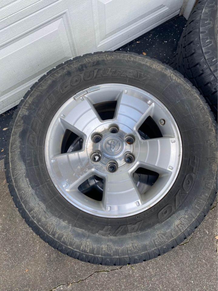

A guy locally has some 17's with fairly low mile Toyo OC in the size I want. Just trying to confirm they go on my '85 manual locking front axle. Obviously without the center cap. Thoughts? Much appreciated!

the bolt pattern would not be an issue, the offset might be an issue
seems like the seller would let you do a 10 minute test fit.
I tried the rims off my old 05 Tacoma and the rim would not clear the caliper on my converted straight axle. due to offset, i would have had to run a spacer to make it work.
if you get the rims make sure you get the correct lug nuts to match the tape of the hole for the lug
