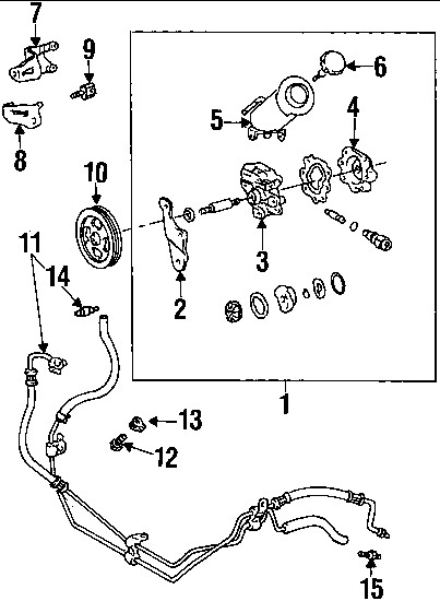

Toyota want about $400 for the new hose and the damn thing only comes as an assembly with the high pressure line and the return line all bracketed together. WTF Toyota engineers? Cheapest price i've found online is $270.

any chance you have a part number for item 15 in this diagram?
