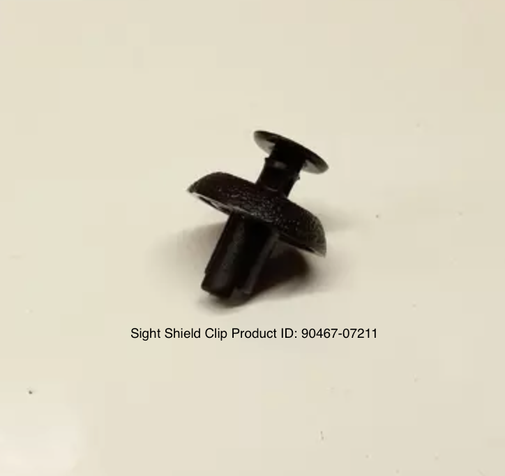

The OG shield clips are:
Sight Shield Clip Product ID: 90467-07211
(push to release type)
Fender Liner Clips 9046707201
(will also work, these you need to pry up and do have a larger diameter head)
