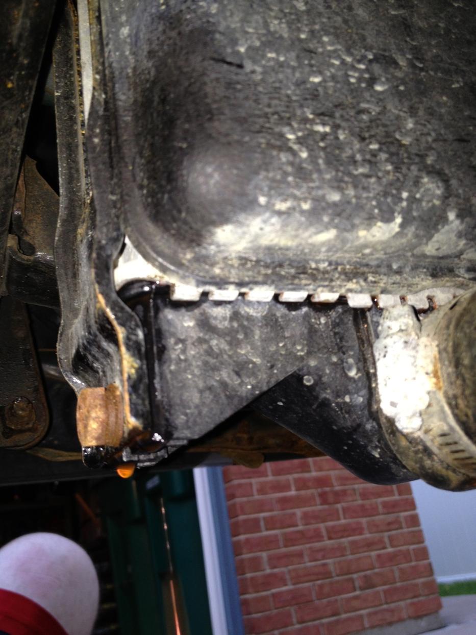

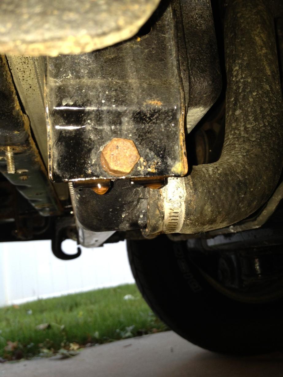

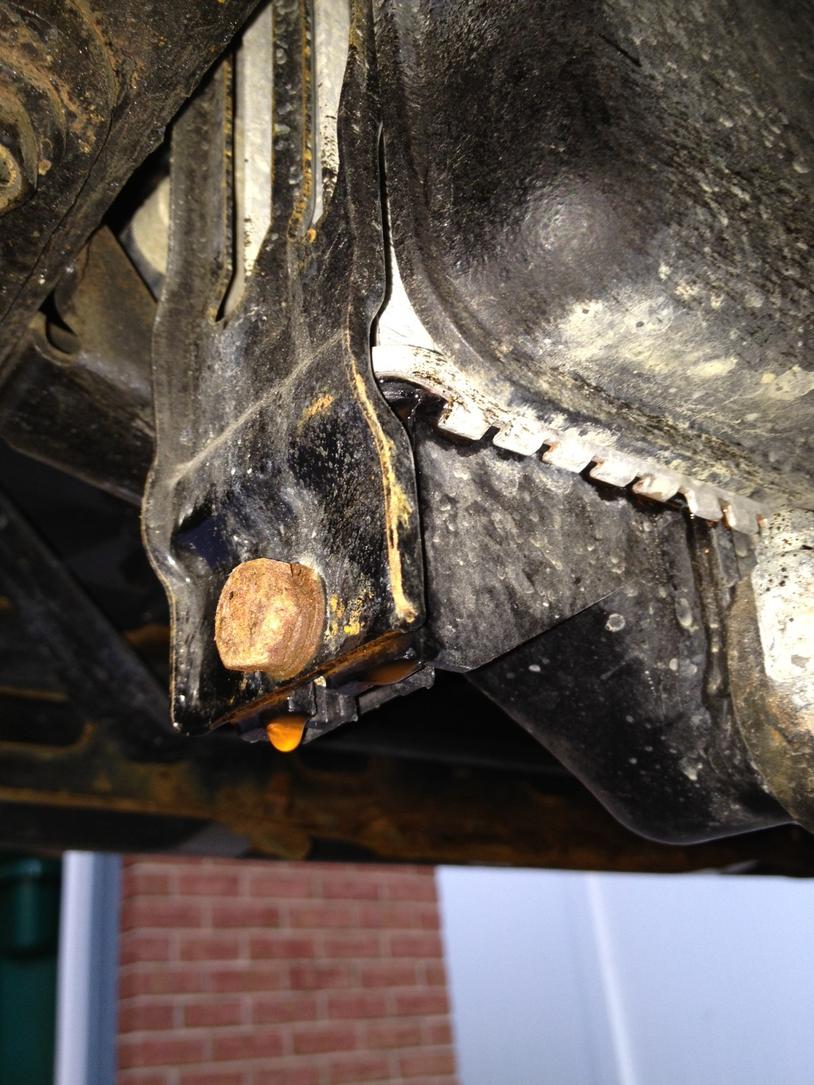

Hey all,
After looking through numerous threads, I didnt anything that was exactly what I discovered this evening after getting home from work.
At first I thought it was AC condensation, but it just wouldnt stop. So after further investigation...it was rad fluid...I removed the skid plate, then noticed the leak was coming from what looks like the rad itself and the mounting bracket...in fact, its still leaking (though "draining" seems to be a more fitting word at this point).
- Should I assume the worst and plan on replacing the rad tomorrow?
- What kind of thing causes this kind of leak/damage?
Hoses seem fine, though the lower ones are a little dirty (expected). Timing/water pump were replaced about 12k miles ago by the previous owner. This is a 2000 Limited AT with 104k miles.
PS. pics look like the fluid is orange, but I assure you it's pink

Are you sure it's not coming from the overflow tank or the cap? What's the highest point you see fluid leaking?
It looks like the highest point is at the bottom "seam" of the radiator where the metal latches onto the plastic across the entire length. No signs of leaking at the cap or the reservoir tank.
Well it's not very often a rad in one of these goes out like that so young but look at it this way, you can put in a new rad and avoid the pink milkshake for at least another 8 years.
I'm guessing from what you've said that, yep your rad is toast.

Damage to me would be a rock through it but that would have hit the A/C condensor first unless it angled in there just right. But the way yours is leaking at the seam (if that's where it's leaking) makes me think it's just a failed part.

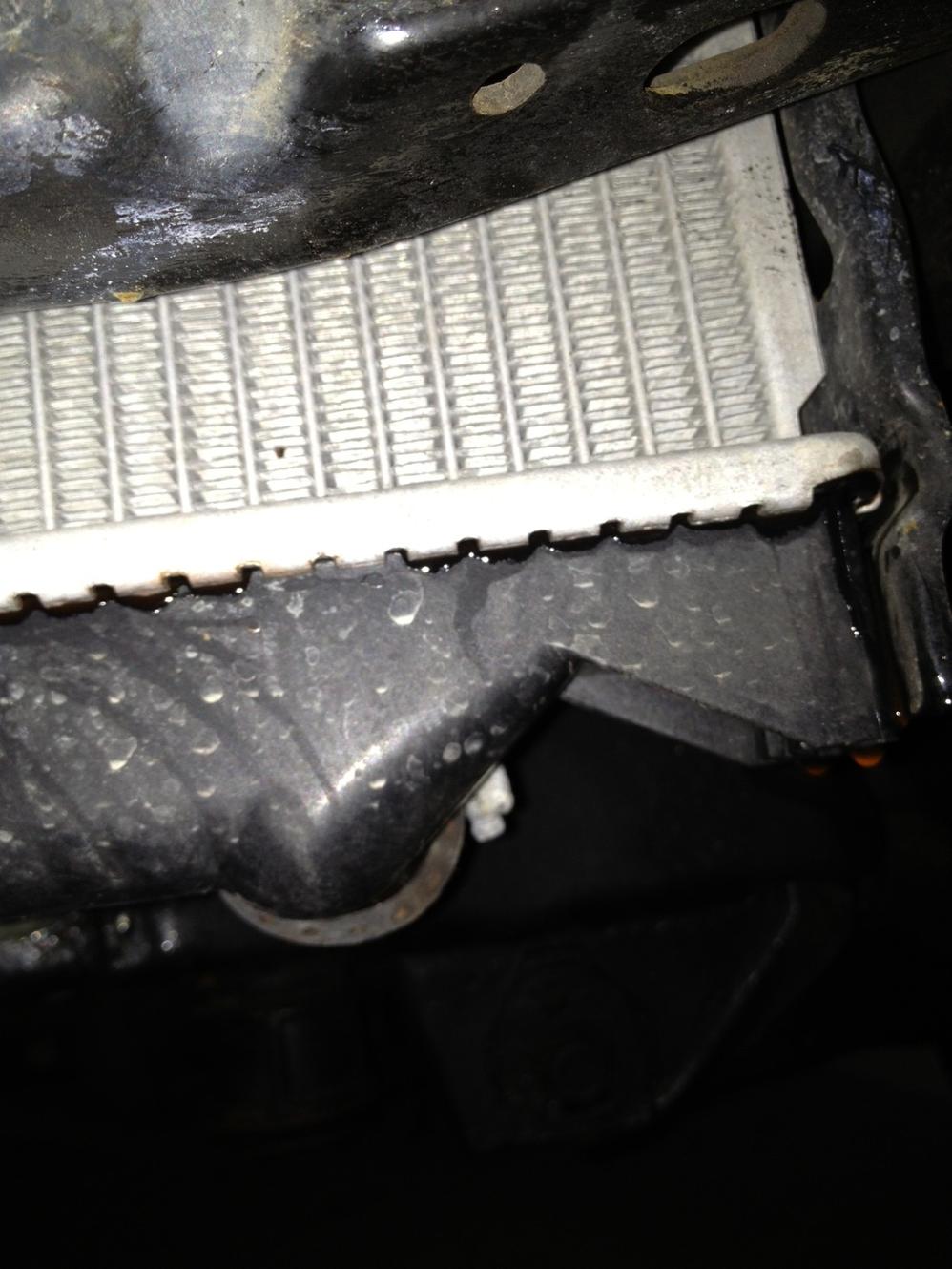

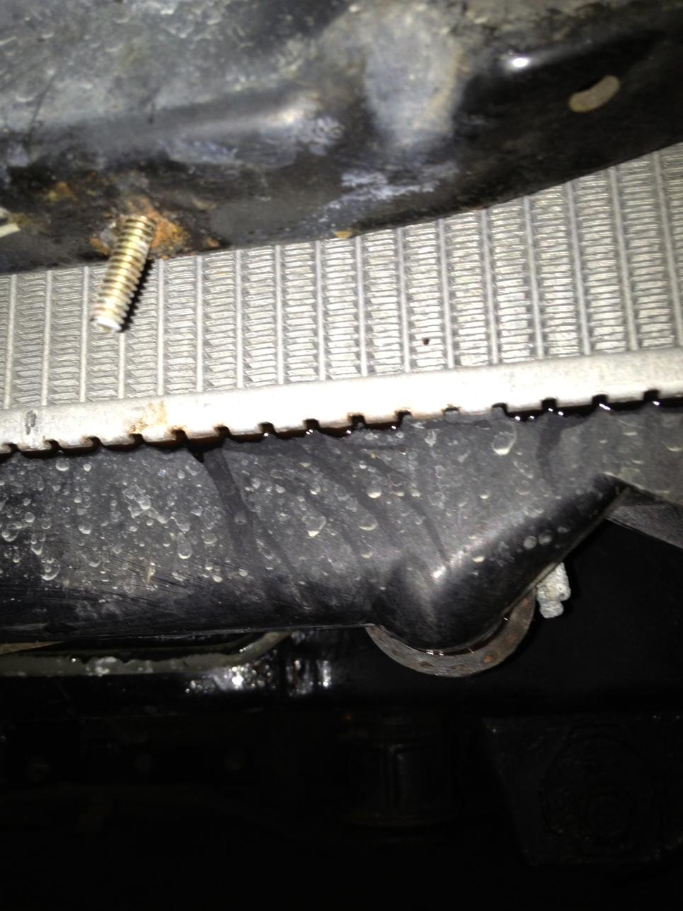

Here are a couple more pictures showing where the leaking is coming from...

In your last couple pics it shows a drop of coolant above the bottom seam. I'm still thinking your leak is coming from higher up.
Not sure if that was actually coolant or not. I ended up changing out the rad. I did notice my trans fluid was about a quart low after warming her up...which was more than i lost with the rad change. Other than having to top off that and the coolant reservoir after it cools off (drove her around for a while), everything seems to be good to go.
