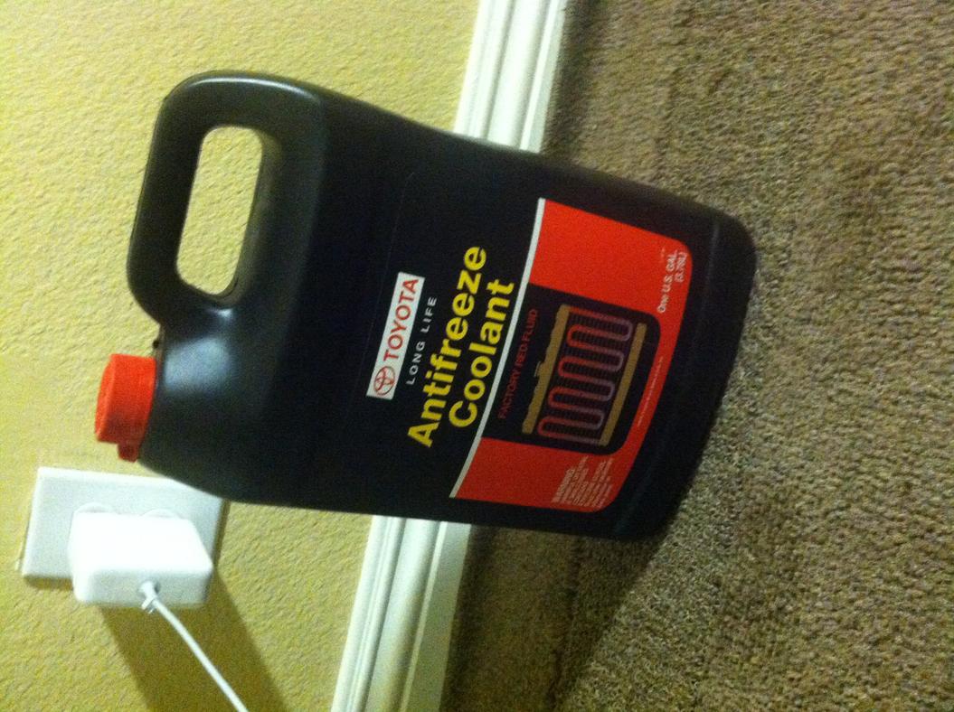

Yes, I did my research but still can't decide well first of my radiator is missing some coolant every time I check which is like every other day it should be expected since I have 261xxx miles. In the meantime I top it off and run it, after I shut it off it leaks coolant but I did notice it just leaks after I filled. I have decided to buy a new radiator before its to late I called my local toyota and they want $325 for a new one which seems ugh little too much. My other options would be to go with the denso for like $100 off Parts geek or the one from amazon the tyc 1998 for $88 that I heard most people run on here or just go to my local auto zone. I do want to pull the trigger on the oem because am going to feel worry free lol :fro:

$325 is just the radiator I already have a gallon of coolant :) and I don't plan on replacing my hoses for now

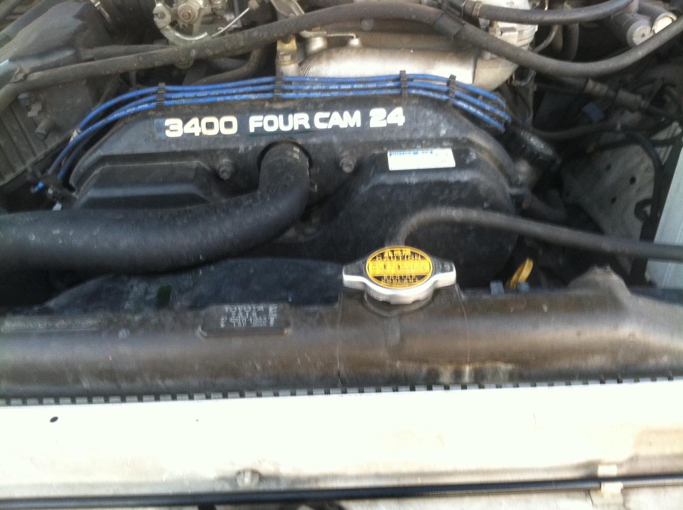

Out of curiosity, are you sure it's your radiator that's leaking? Caps and hoses are much more likely to leak than a radiator, IMO.
Replacing the rad but not your 260k hoses seems silly to me.
Am pretty sure it's my radiator it already has a crack going across under the cap and yeah I should change the hoses as well
