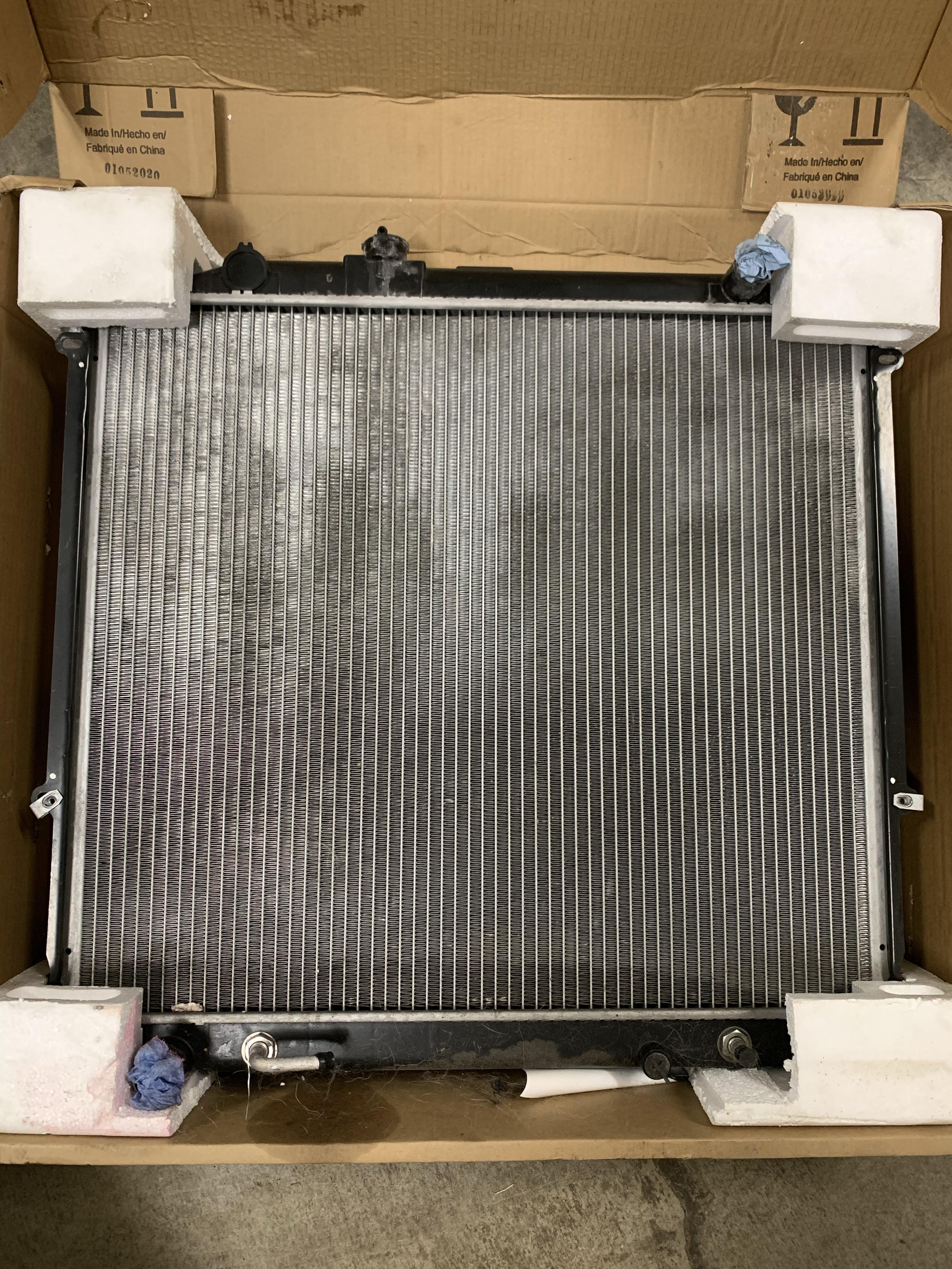

installed this maybe 20k miles ago..no issues
