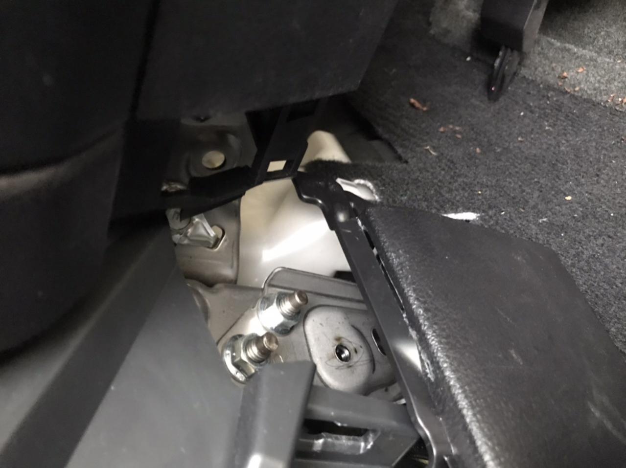

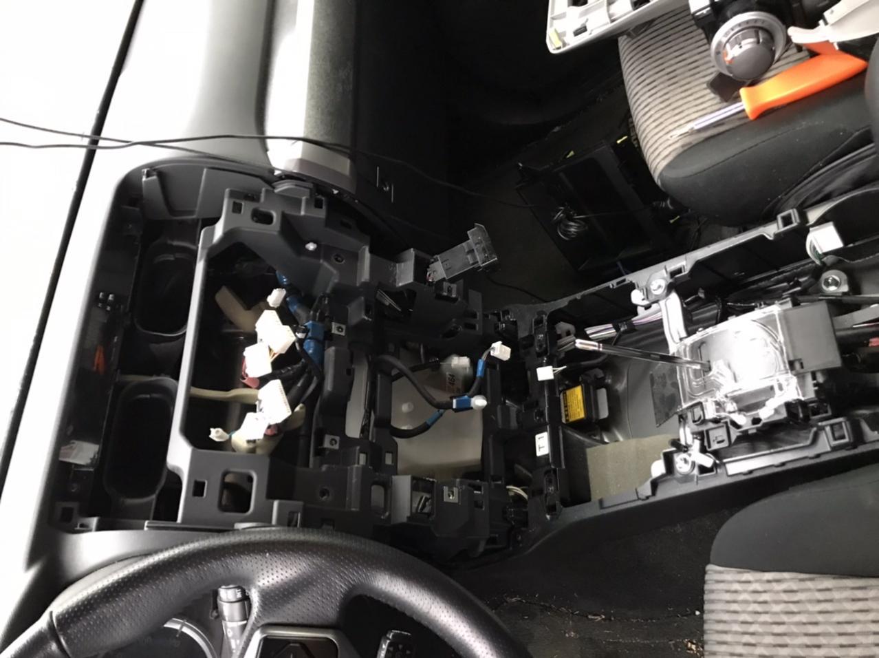

Removed wire harness of dimmer, heated washer tank, radio, gps, power outlet, usb, AT gear indicator, rear window switch, 4WD switch, almost all visible wires had been checked, still no luck. Blew several fuses again ...
I unscrewed the airbag and glove box but didn't proceed to remove them. Not sure how to grab the glove box to pull it out. There's no good place to put hand on and firmly pull it. I saw two links both mentioned to pull it out straight. Still not sure if I'll break any plastic parts. Couldn't find a video for that.

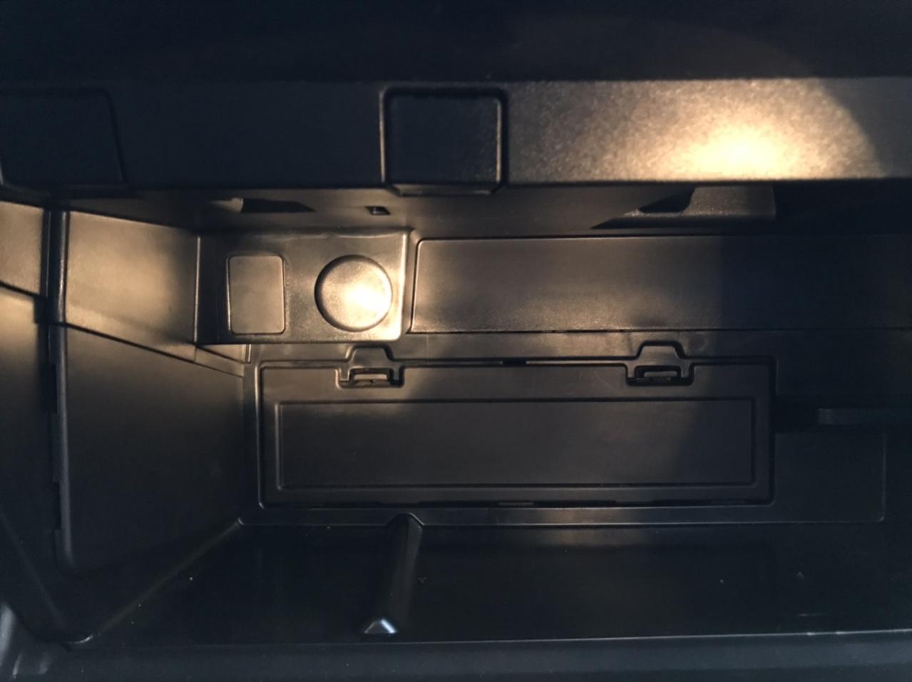

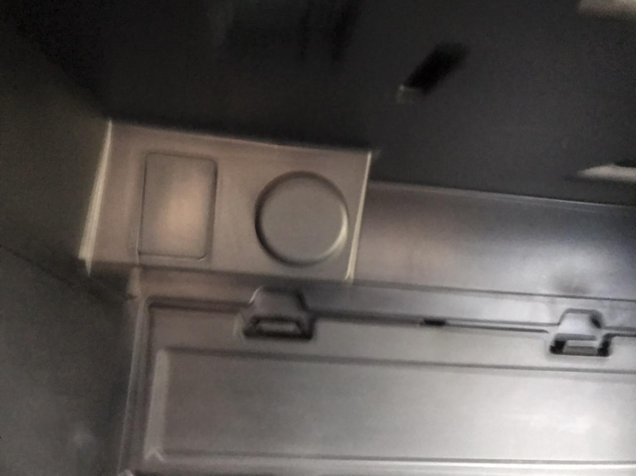

My glove box doesn't have any light inside and out. I reached to the back of the glove box and found no wire in the power and outlet area. Mine is bare bone SR5 so no power outlet inside the glove box.
I never touched any wires before. the only thing I can thing of is the airbag has been recalled and the mechanic may have worked on the wires there? Where should I check next?

Pictures of the wires I disconnected

Since the fuse keeps blown up, can I use a headlight or taillight bulb with two pins inserted into the two holes of the fuse box to bypass that point so I can visually see which bulbs were still good and which are not? it might be a short circuit somewhere but I added a load at the fuse position so there won't be overheat in the circuit, am I correct?
Not necessarily. Fuses blow for overcurrent situations. If there's a short to ground and your light bulb just lets that happen, you'll potentially start a fire.
