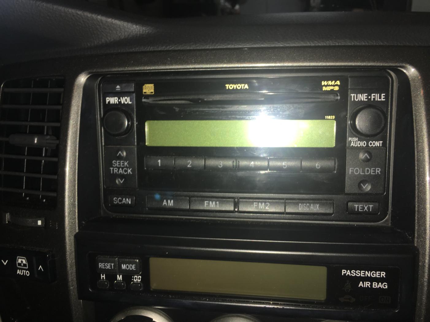

I am trying to add a new radio. I am looking at the Pioneer MVH-1400 NEX. Goal is to not have funky trim. Do I have the right trim bezel already? 2008 Sport without JBL

you will need the metra 95-8202 radio dash kit.
Metra Part # 95-8202 | Toyota Scion Dash kit | Metra Online
do you have all the harnesses and bypass yet?
make sure to get the motorola y for antenna and also the gm antenna adapter to use the smaller antenna plug.
how about steering wheel controls?
idatalink maestro rr
I have nothing yet. Just starting my journey. Ordering tonight. Was going to order from crutchfield for the harness unless you can recommend one.
get the stuff from crutchfield. itll come with harness and trim kit, which will save you a few bucks.
