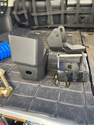

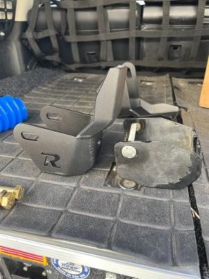

Why do you need rear shock skids:
low hanging fruit.
1. my passenger rear skid is mangled from high speed desert runs, rock gardens, and desert hill climbs due to to contact with loose boulders. You can see all the touch up paint in the pics.
2. If you play in rock gardens, and you slip off a rock/boulder, you will turtle on that shock mount and destroy your lower shock mount or frame mount. The shock skids can handle being turtled.
3. If you hillclimb, your front tires will kick loose boulders downward, and it will usually get caught by your rear shock mount. If you are in a convoy, you will be eating alot of the loose boulders, the vehicles in front of you is kicking up.
4. If you are desert running or in a convoy, your rear shocks is going to get pitted to death, and you will have a rear shock failure eventually.
5. rebuilding shocks ain't cheap.

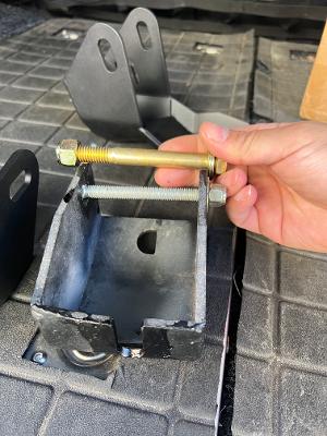

Why Rago Fabrication's lower shock skids.
1. It has "more" shaft protection versus the competition. My lower shaft is pitted and starting to corrode. It was either new shock skids with shaft protection or shock booties.
2. The steel used to protect the shaft is gussetted or reinforced, so in theory, it should not deflect into the shaft body if pinned against a waterfall/ledge/rock. (more on this later).
3. It has drain holes. My old shock skids did not have drain holes, and my spherical bushings is pretty rusted at the moment, and the old skids is also showing signs of rust and mud.
4. heavy duty hardware. Rago uses a 19mm nut and bolt. Whereas, the competition uses a 14mm nut and bolt. The 19mm nut and bolt fits better in the hole, less likelyhood of ovaling out the frame mount over time and less deflection if there is a big hit.
Why you wouldn't use Rago Fabrication's lower shock skids
1. If you play in the rocks alot, I wouldn't want the shaft protection in case of accidental deflection. I would run normal shock skids AND shock booties instead. Weird things tend to happen when you offroad.
2. It's more expensive than the competition.
3. If you run thicc/upgraded/aftermarket rear lower links, there might be some interference between the shaft protection and the lower links. I run metal tech lower links and they are THICC YO!!! I have maybe half a inch of clearance between the links and the shaft protection. In theory i should be okay, since the lower links travel arc is inboard of the the shock mount and should clear when flexing. I haven't tested that theory yet.
Conclusion:
Not saying Rago is better than the competition. It all depends on what your budget is, and where you like to play. However, I would NOT buy other manufactures that offer shaft protection but is NOT gussetted. None of that ICON bullshit. I would rather buy skids with no shaft protection than a skid with improperly designed shaft protection.
cheers

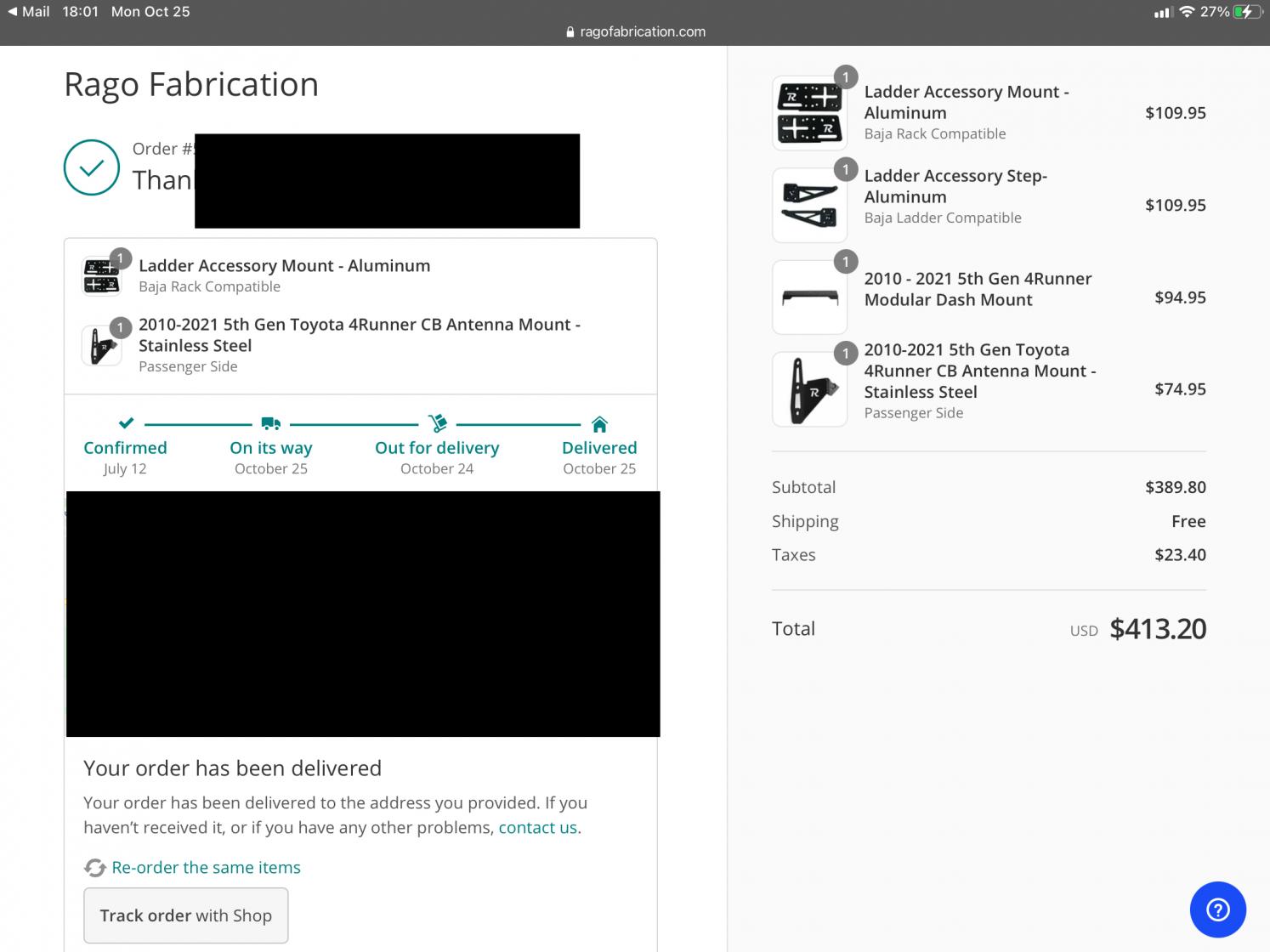

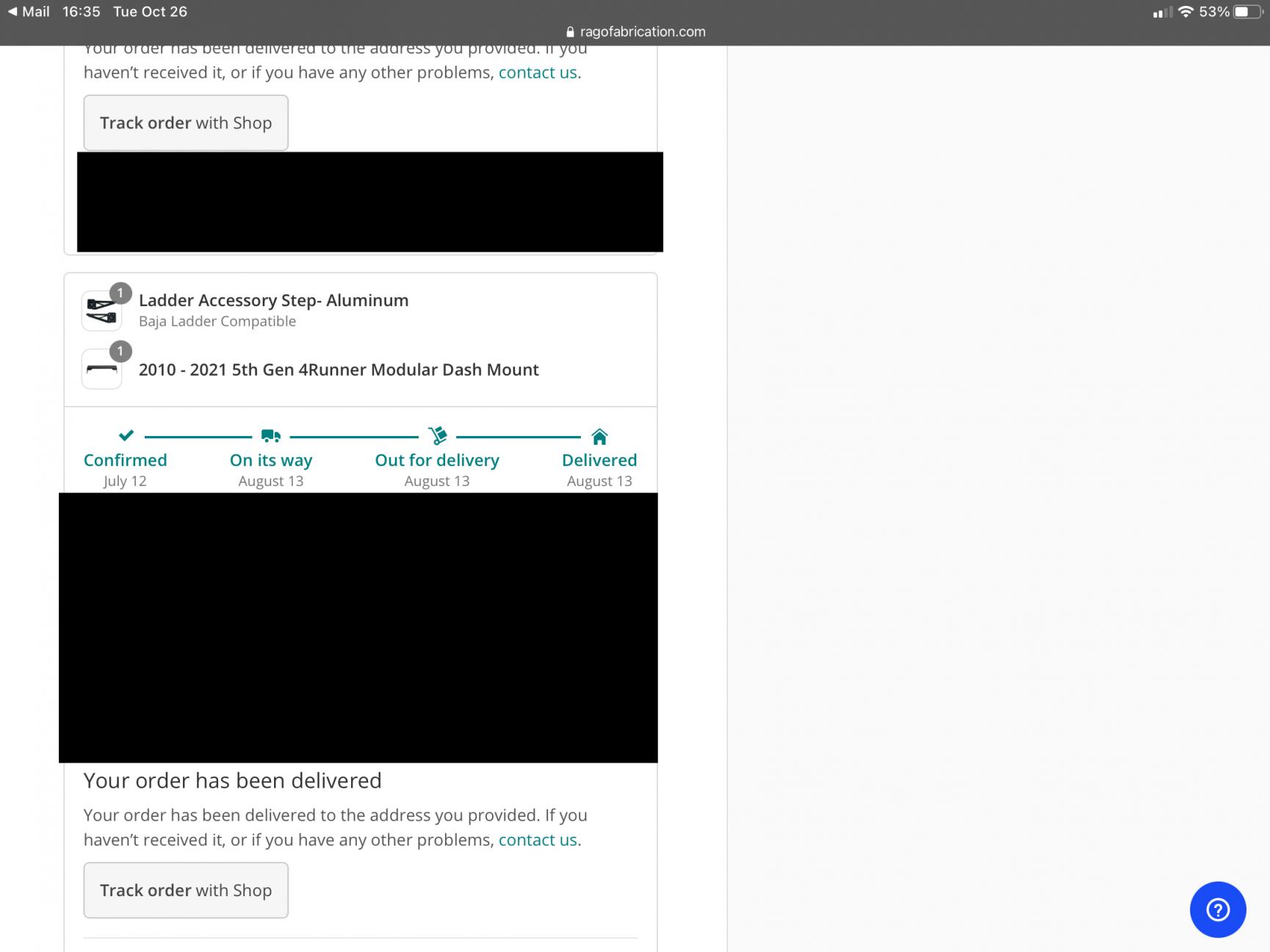

Rago makes outstanding stuff but my experience with them since July 12th has been a nightmare. I placed an order for a few things that at the time all showed in stock on their website. Plot twist, none of it was in stock. The lead times on their website showed 2 weeks. Another plot twist. It would be 4 weeks later before part of my order shipped. After I received my order in the middle of Aug I waited about a week and then I reached out to Rago about the rest of my order. Rago informed me that a powder coater lost items and the accessory mounts and antenna mounts would ship out in a couple of weeks.
Still missing part of my order I contacted Rago in the middle of Oct about the rest of my order. This time told they switched powder coaters and my items, a ladder accessory mount and a passenger side antenna mount were due back from powder coat any day now and would ship in about two weeks. Last week, I receive an email showing the accessory mount and my antenna mount had shipped. The package arrived Wednesday, opened it up and there was my accessory mount. It again looked outstanding like the previous parts. However no antenna mount. The packing slip doesn’t list it, (I have a pic of the packing slip). The antenna mount is not there. I again reach out to Rago and get the same canned response that they switched powder coaters.
So on items that showed out off stock or with a lead time of two weeks, it has now almost been four months. Rago makes some really nice stuff with some outstanding build quality and excellent welds but their lack of transparency when it comes to stock and lead times means that for me, moving forward, no matter how nice their products are, I won’t buy from them again. YMMV.
