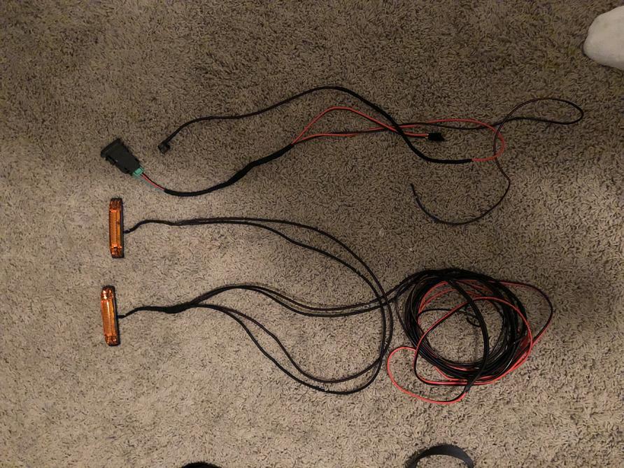

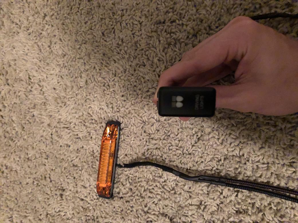

I had seen several posts on the raptor led mod with a big variety of how people put everything together both with the location on the grill as well as the model year of 4Runner. This writup is for the 06-09 grill as I could not find a writup for those model years. The supplies you will need are as follows:
50 ft of 18 gauge red/black wire (Amazon)
Amber led strip 2x (Grand General 77650 Amber Thin Line 6-LED Marker and Clearance Sealed Light)
Fuse tap for my application (mini fuse APM)
Wire loom (25ft - 1/8 inch Flexo PET Expandable Braided Sleeving – Black – Alex Tech Braided Cable Sleeve)

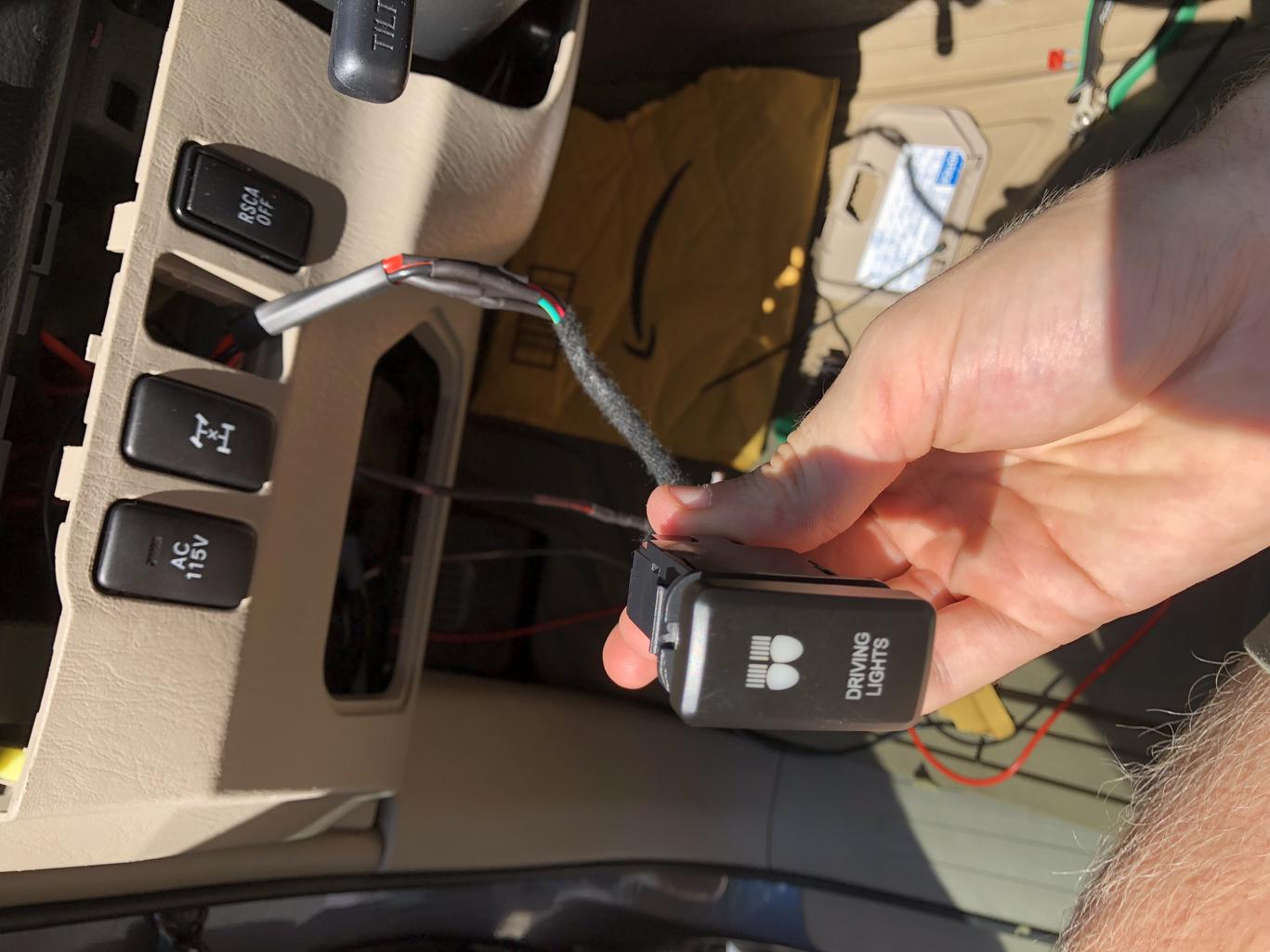

Switch (Cllena Toyota Blue LED Push Switch with Connector Wire Kit Laser ( Driving Lights)
Useful tools:
Soldering iron
Heat shrink tubing
Tessa tape
Things to note: I had seen this mod where people had tied it to either the daytime running lights or marker lights for night time but I didn’t like this option. I wanted to be able to use it whenever the car was on but still have the ability to turn them off with a factory looking switch. Also the wire loom I used does fit but I think if I didn’t it over I would have gotten 1/4 inch tubing instead.
I currently have wired everything up for install and will add more information tomorrow when I put it all together

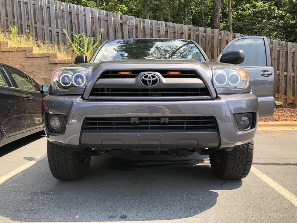

Appreciate the replies! I just finished everything up and am going to post the rest of my writup. I have to give credit that I got the idea after I saw Whytey's '07 V8 SE Build where he did the same thing (also Simple yours looks really good!)

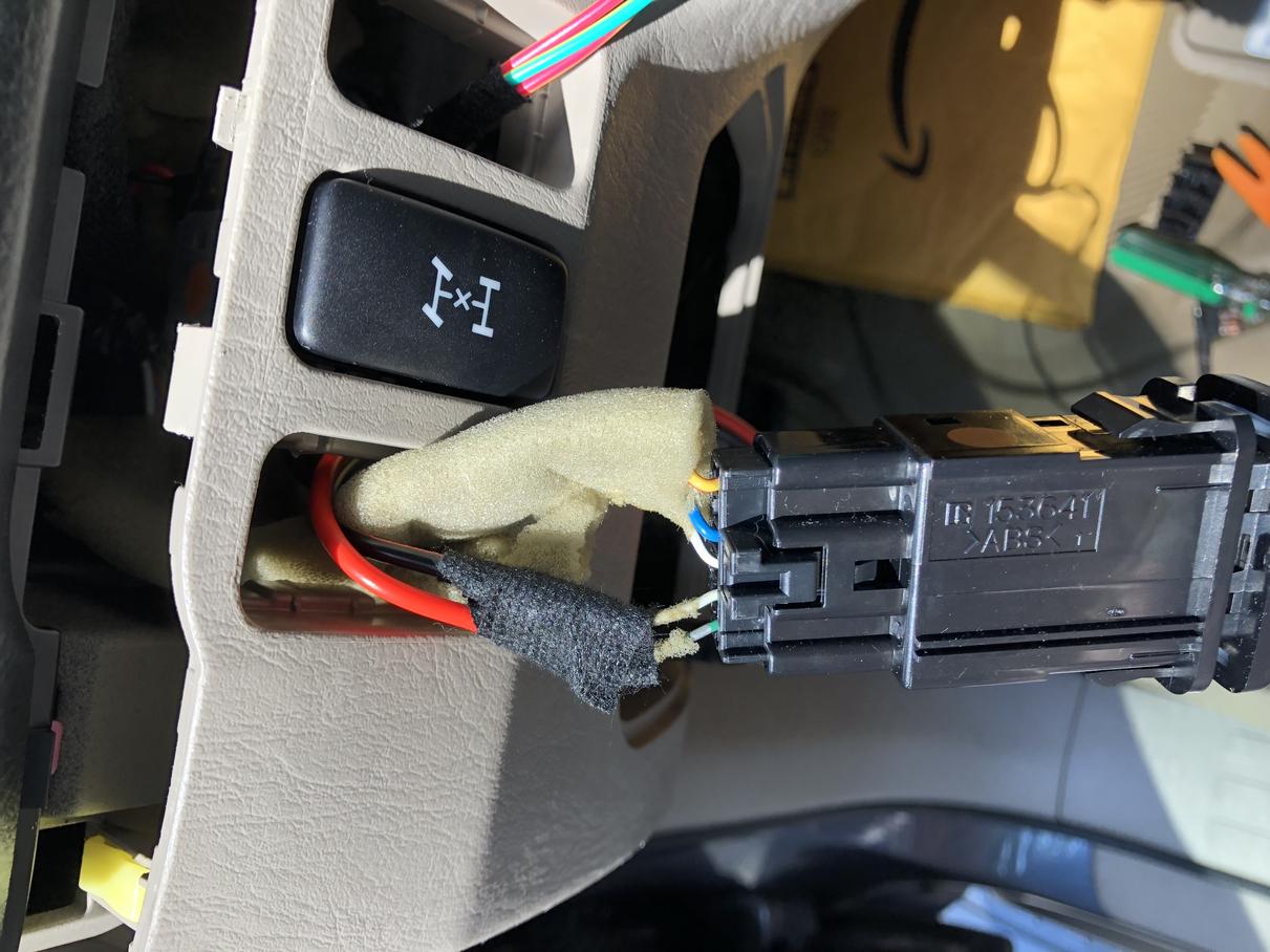

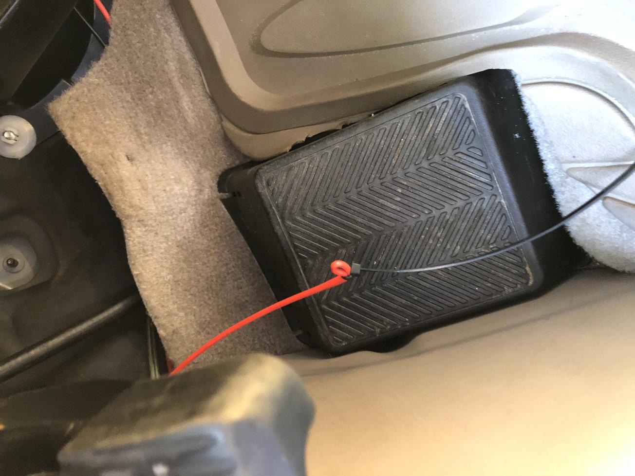

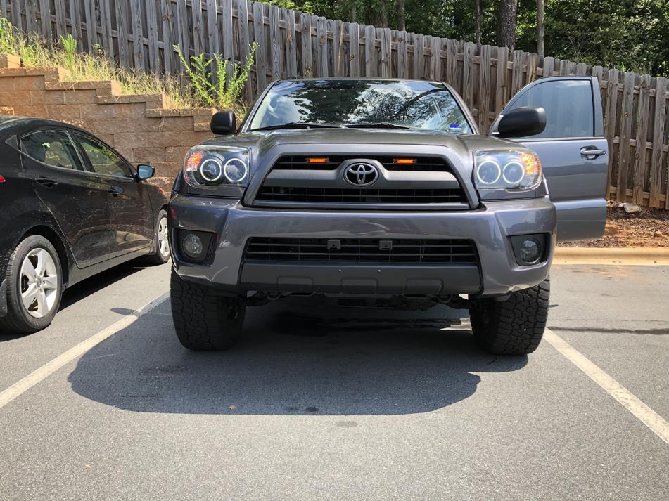

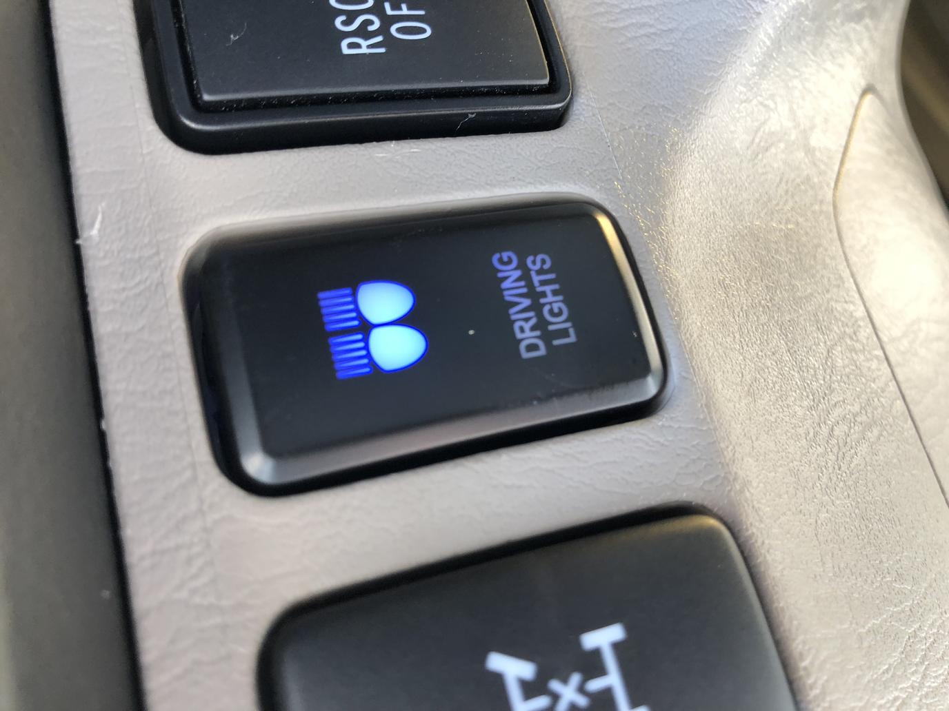

Install writup

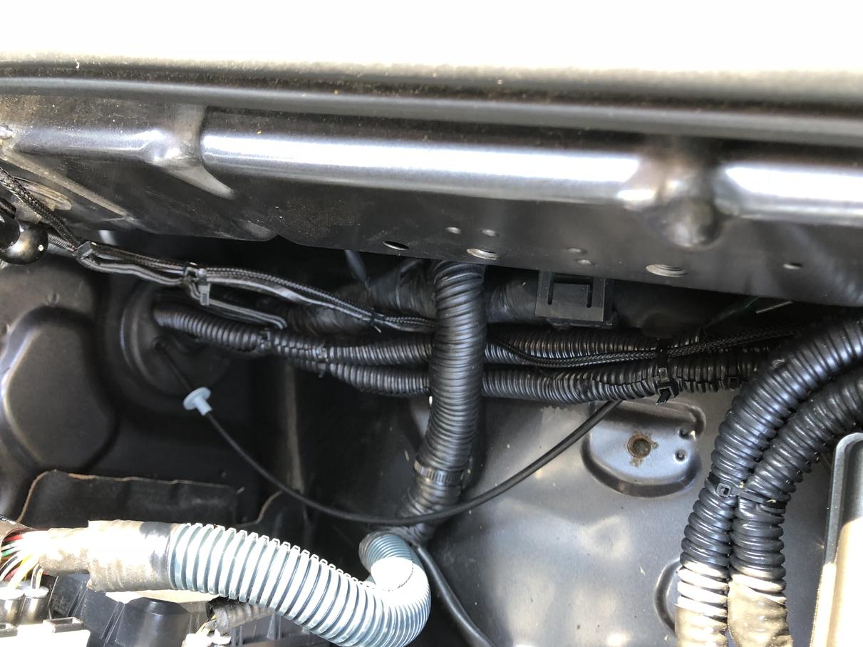

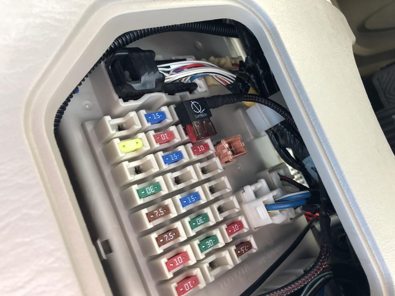

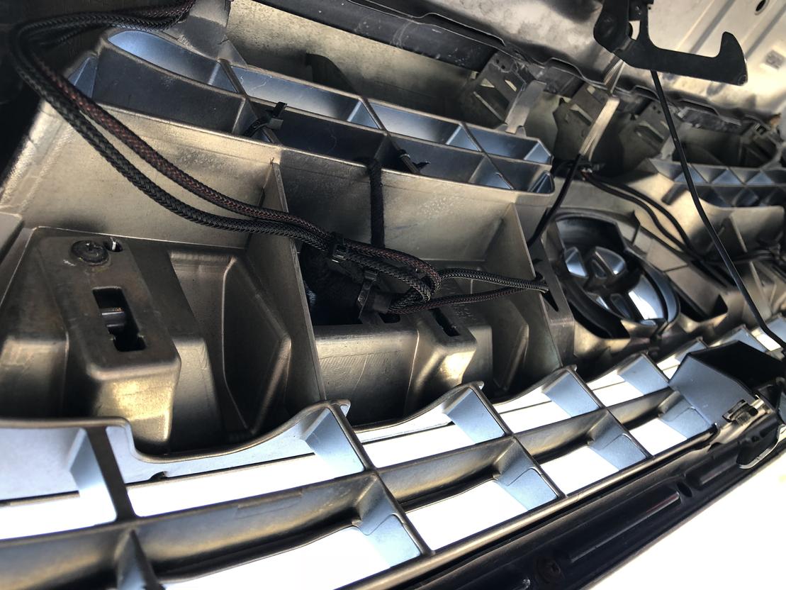

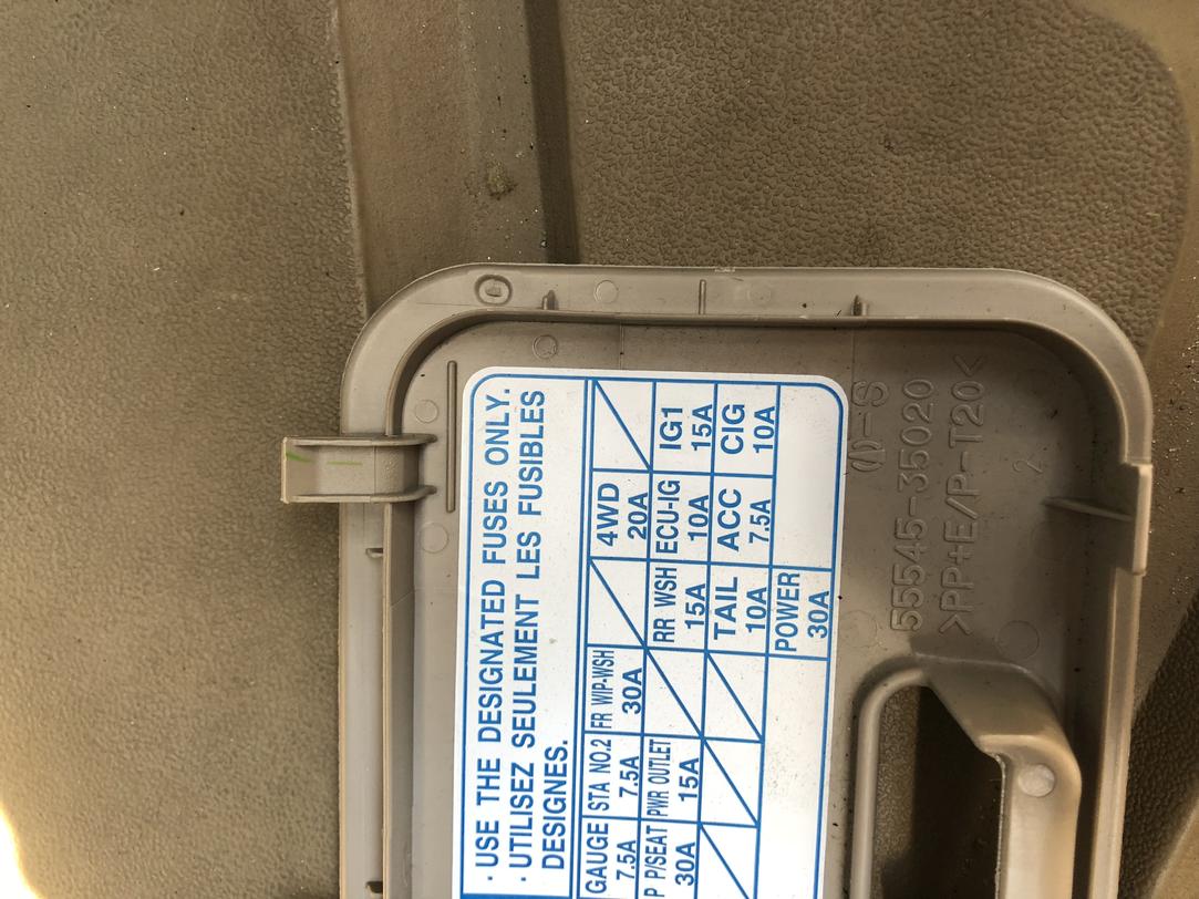

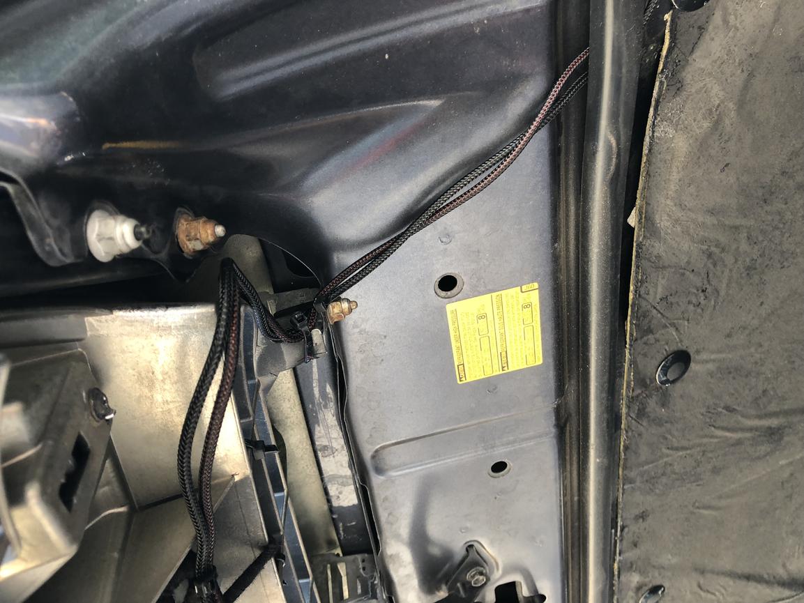

I just finished everything up and thought I would share the results. I like the look and the fact that I can turn them off is really helpful. First off I began by securing the leds to the grill. I did this with black zip ties as they were the easiest to work with. Next I routed my wire harness I made up the side of the grill and down behind the hood insulation. Then ran the ground to chassis and the positive into the cabin through the firewall. Next I took the other wire harness I made and ran the wires for illumination to the 115 volt outlet and then ran my hot wire to the fuse panel where I tapped the cigarette lighter fuse and then used a 7.5 amp fuse for the new circuit. Next I ran the other wire that came off the switch to the power wire I brought through the firewall. Next I reinstalled everything and am enjoying my new mod! Will be posting night pics once I get the chance later today

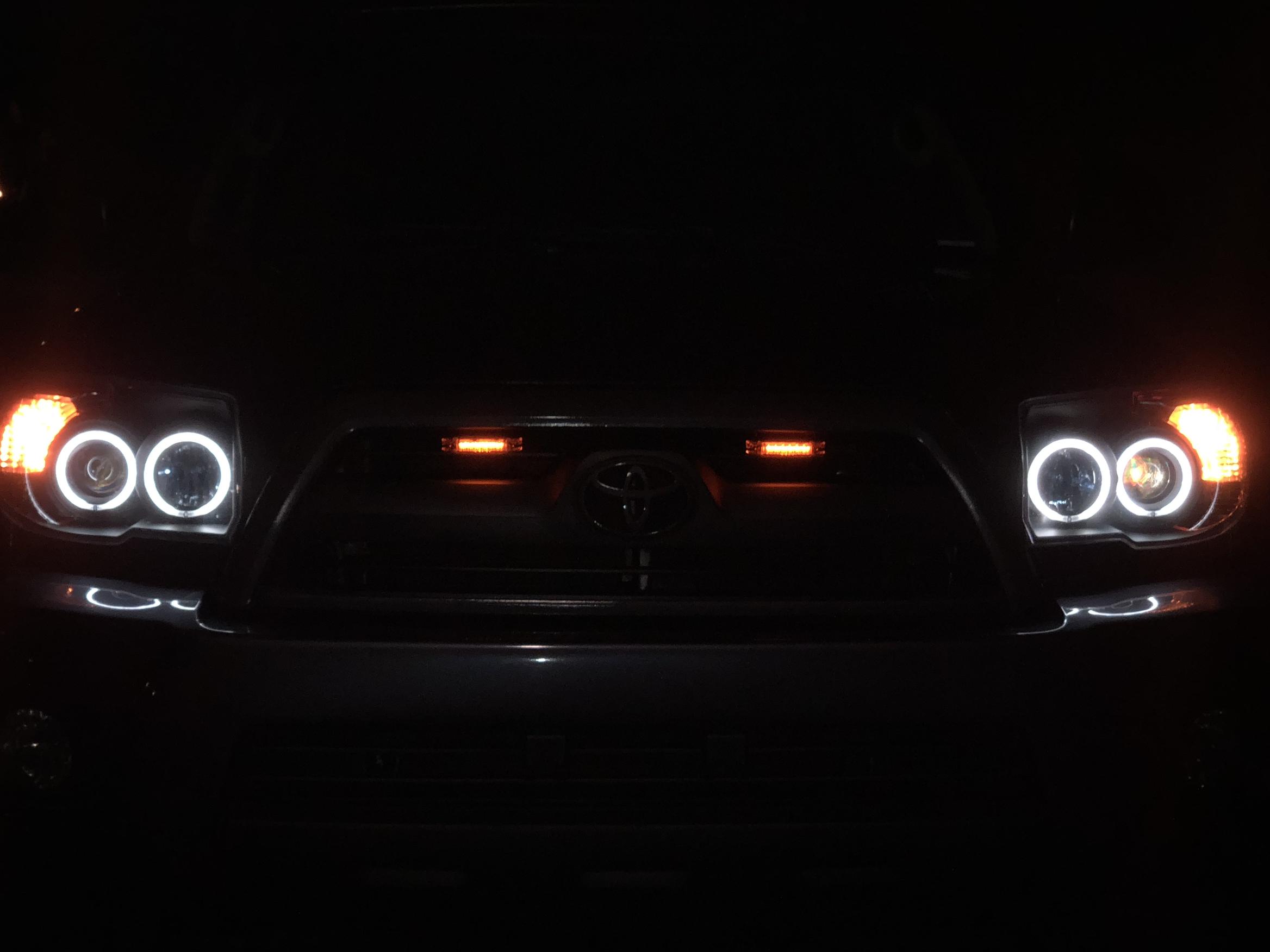

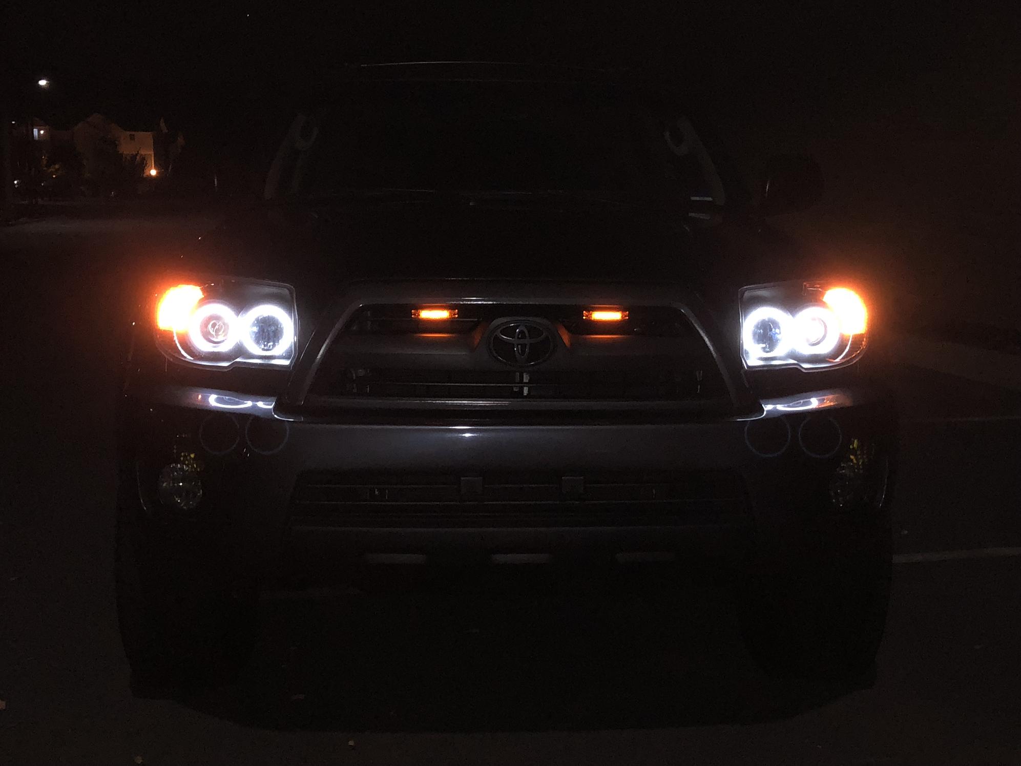

Midnight runner
Finally got some decent pictures for my post lmao.
