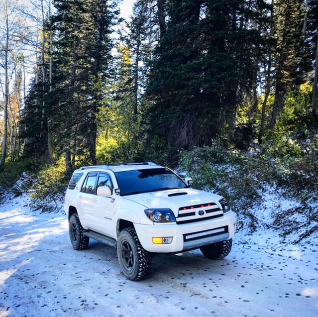

Did a similar install on my last 4runner. Went under the insulation on the hood, through the firewall, and opted for the easier add a loop and into the fuse box. I pulled everything out before selling and if I install again on my new one I’d like the option to be able to turn them off. Thanks for the write up!

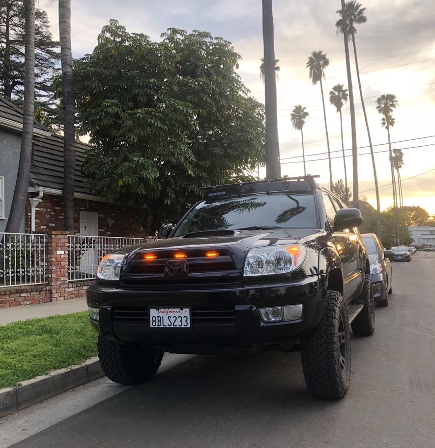

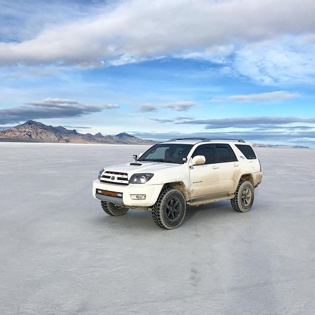

I also did the raptor lights. looks great i think.
never understood why people do the "raptor mod" but dont do 3 lights and dont do them as dots. They're a DOT thing for width. If you're doing more or less than 3 and doing them as bars its not a raptor grille.
