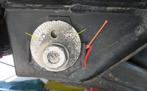

I actually know where mine are coming from. Truck isn't aligned properly due to an accident. The adjustment on the driver side cant be made due to the tabs being bent that are supposed to allow the bolt to move the adjustment. Caused the truck to pull left, in turn has work the outer edge of the right tire. Which contributes to the problem. Along with the steering bushing probably needing a replacement.
makes for a fun drive. All vibration is on the steering wheel. My driveline seems to be just fine.

No pictures of mine but essentially, it looks like the this and the red line is what mine looks like. So when you turn the bolt, it cant lean against the tab to adjust the camber. Needs to be bent back and bead welded. Might need it on the back side too. I've been too afraid to take it to the frame guy lol.
